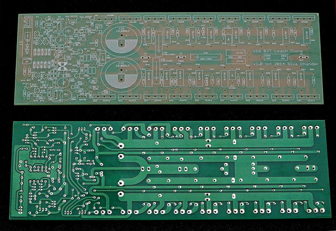

Folks, as the title says: This is a preliminary GB for a Leach Low-TIM clone based on Jens Rasmussen's last published schematic, with 2 additional output pairs for better SOAR management (and a few other minor modifications). Almost all the parts designations have been retained the same as the Jens Rasmussen BOM. With 8 + 8 2STC5200/A1943 outputs and +/- 75V rails, this should comfortably manage about 300W into 8 ohms. Higher rails are possible with appropriate transistor substitutions. Each of these boards is a monoblock of dimensions 265mm x 95mm (see attached picture).

hi, what is the size of the boards? are they 1 oz types? thanks...
They're 265mm x 95mm with Cu thickness of 70 microns (2 oz.). I forgot to mention that there's a jumper for an optional ThermalTrak-style 3- or 4-diode chain for the Vbe multiplier. The diode chain can be mounted on a small piece of vero or perfboard and kept in close thermal contact with the heatsink, and the two ends of the chain are connected to the jumper. Alternatively, the diode chain can be omitted and the jumper shorted.

This is a response to a query about the input DC-blocking capacitor.
This Leach clone has an input DC-blocking capacitor footprint that allows several options, with
the help of the 3-wire input connector that brings nets from both sides of the on-board footprint to the connector:
1) Use either the 5 mm or 27.5 mm pitch (or one of several alternate pitches provided with vias) and populate it with any film or electrolytic cap of your choice (radial, box-type or tubular axial) that will fit in the space provided.
2) Omit the DC blocking cap (either by jumpering it, or using the alternate input line from the 3-wire input block that bypasses the DC blocking cap).
3) Use an off-board DC blocking cap (typically one that's too large to fit on-board), using both input signals that connect to the two sides of the on-board footprint. You can also populate the on-board DC blocking cap, and use a higher-quality off-board cap to bypass it (say 5mm 1uF Wima MKS2 on-board, bypassed by an axial 0.1uF PIO or Teflon off-board).
4) Use just an electrolytic on-board - it's not as bad as people think. I've measured some electrolytics that have dissipation factors that are pretty close to some film caps, in the region of 0.3%. Of course, these could still be bypassed with a higher-quality film cap, either on- or off-board.
Any chance you might offer one of Jens' Leach clones with fewer output transistors?
In principle, you can populate this board with as few as one output pair (or any number from one to eight pairs). If the voltage rails and a few biasing resistors are adjusted appropriately, it will work. The main downside is the waste of space inside the cabinet - the PCB will extend quite a ways without anything installed on a portion of it.
You can hack off a portion of the board with a hacksaw, but you'll have to deal with repositioning the Zobel and the output inductor suitably (maybe off-board or omitted).
One could populate alternate device locations for a wider spacing of devices on a big sink.
I did the original 3pr Jens' clone and used 230W To247 using a 40Vac transformer.
It was easily able to drive any severe reactance 8ohms speaker.
Using my definition of determining the rated speaker impedance it came out as a 6ohms suitable/capable amplifier.
I could not justify the 3pr as a 4ohms capable amplifier.
It could easily drive a 4r0 load, but that is a quite different duty (although a thoroughly good test for a 8ohms capable amplifier).
