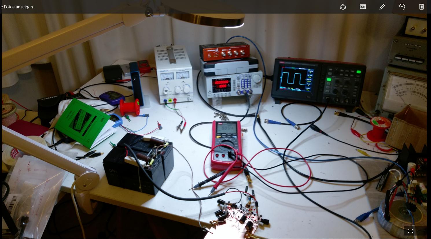

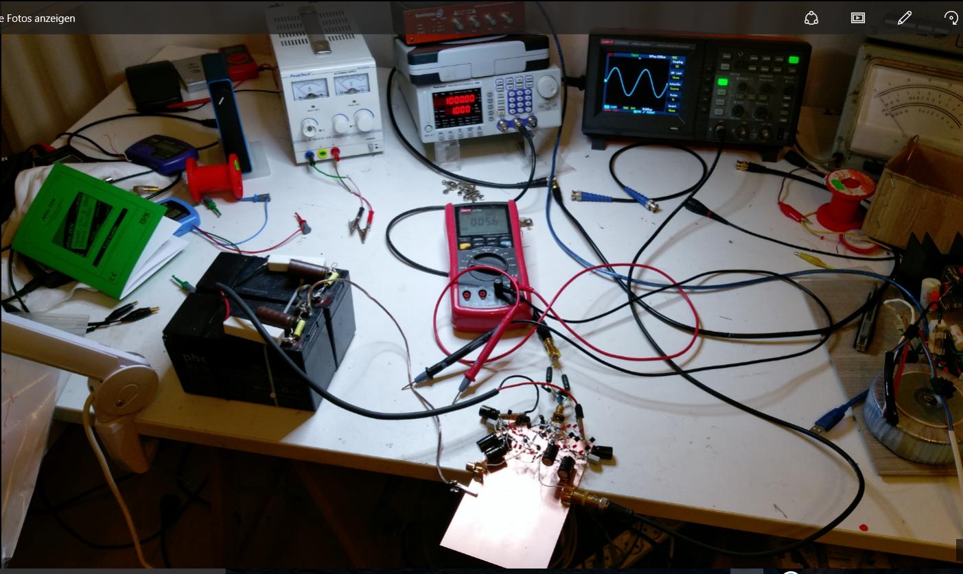

Frans and i have made an input stage. It is more or less a combination of what we learned.
It is differential in - differential out so that allows for balanced operation. It is DC coupled.
It is low noise without paralleling many transistors. It is conceptionally simple but high performance. I build a prototype today and i am impressed. I show you pictures and more data soon.
Here is a sinewave and a 10kHz square. Open loop bandwidth is 210kHz ( -3dB ), open loop differential gain is around 800 x.
The circuit is thermally stable and has no overshot without compensation. I am impressed how close this build came to the simulation.
