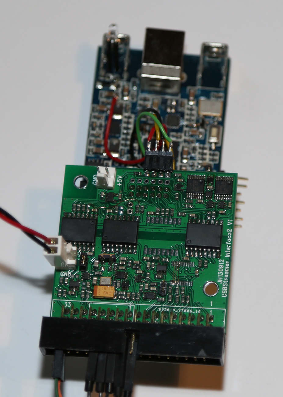

1 Attachment(s)
Here is a picture of the prototype, attached to the USBStreamer. The PCB is 5x5cm.
A couple of modifications were done on this to test the fast isolators. For a basic version, with just one I2S channel in and out, only two isolator devices are needed.

That can probably be arranged. I have just made a couple of new layouts. One is a slightly modified version, with footprints for the faster isolaters. They come in a different configuration than the ones I used for the first design.
The other one is a simplified version, with no on-board oscillators. So this one relies on having the oscillator on the ADC/DAC board (where they should ideally be placed anyway). It cleans up a large part of the area on the lower end of the PCB shown on the picture above. I have just submitted the simplified version to the PCB manufacturer yesterday.
An advantage of the simplified design is that it will be easier to mount. In this case the most difficult components will probably be the SC70 packages. The versions with on-board oscillators use a couple of US8 packages, which are not exactly DIY-friendly :eek:

JensH 23rd October 2013 12:45 PM
Hi Martin
Thanks for your kind words.
Actually the form factor is the same, so the board is still 5x5cm. I could have chosen to make it smaller, but I didn't. I did add some mounting holes though. And I shifted the connectors to the side, so that the existing mounting hole in the upper left corner is easier to use, without getting a conflict between the screw and the USBStreamer below.
If only a 2 channel output or a 2out/2in is needed, it is of course not necessary to mount the 2x17pin IDC connector at the bottom. In this case e.g. a 2x10 pin connector (or smaller if some features are not needed) can be used. For every signal pin there is also a ground pin to get a good signal quality.
