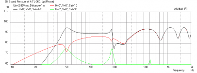

How deep of bass extension do you need? This driver has a fairly low Qts so getting it to go below its fs using a MLTL is tough. Is a slender 5 in x 5.5 in footprint but 20 in tall box too big for your desktop? If not, this Karlsonator (scaled down) design could work - sim is for speaker placed 8 in away from the back wall (assuming desk is against the wall).

Exactly.....desktop use where I don't really want 40hz content bouncing from the desktop and since we're talking nearfield, I doubt excursion limits will be a problem. My idea is for a tall enclosure to get the driver up at ear level......say 18" or so....but instead a wide baffle to remove the need for a BSC circuit. I want to keep the xo minimal with only having to deal with the rising response. But when I model it in a BR in Unibox, I'm kinda disappointed with the extension. I really don't have any practical experience with MLTLs and the like.
.....and don't have any knowledge of a Karlsonator either......every time a view a thread, the reviews of the design are great but the accompanying measurements show the top octave takes a big hit?
xrk971 4th September 2013 07:53 PM
The simulation is not accurate in the top octave for the Karlsonator with smaller 4 in full range driver. In reality, the highs will be there and very good - the simulation is a 1-d lumped element model, and as such, does not account for the fact that direct radiator has a very open access to the front through the larger part of the K-aperture. I run my Karlsonator with 3.5 in drivers and the highs (at least to 16 kHz - limit of my hearing) are very present and excellent sounding. Listen to the mp3 clips in the mini Karlsonator thread and judge for yourself. The drivers will be at table level (5 in or so up) and angled up - so they should work quite well for desktop use. They are tall though.
