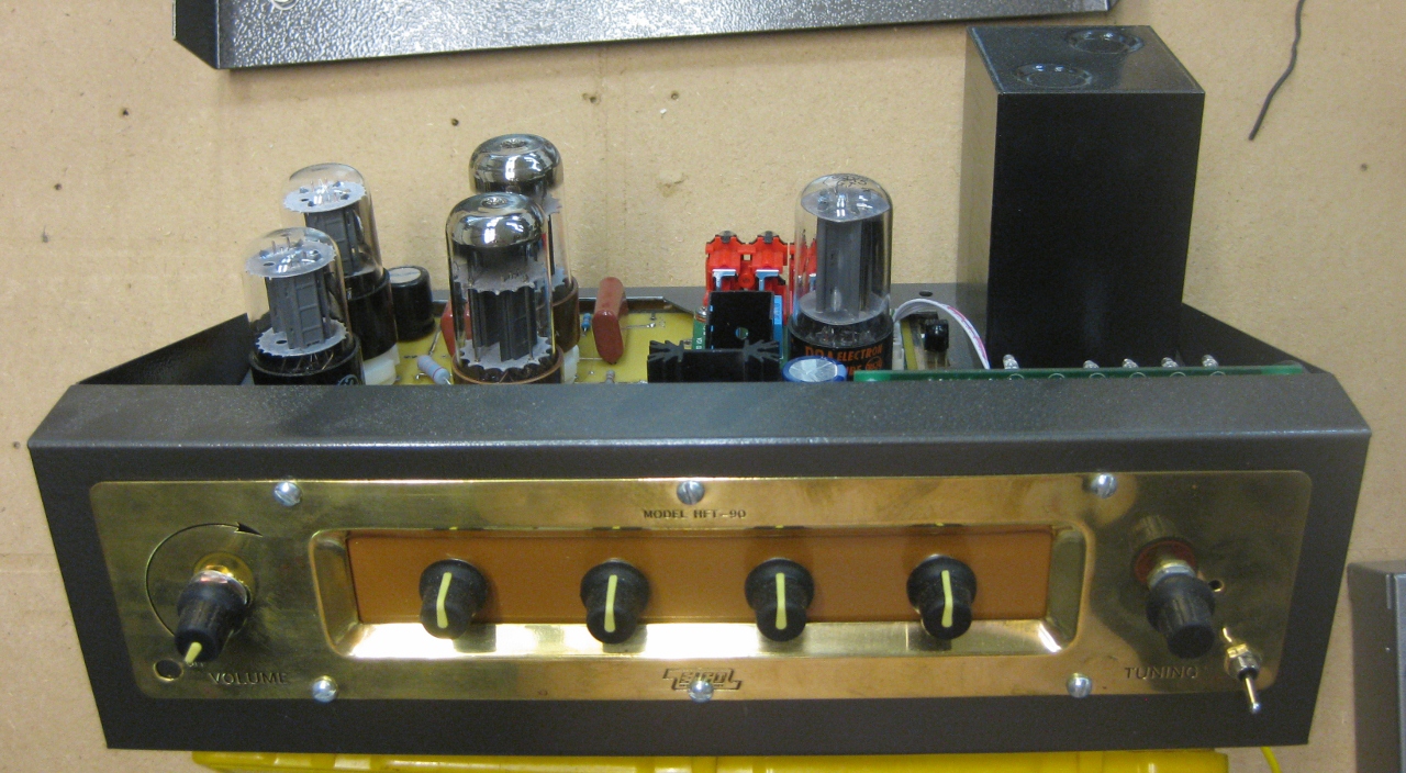

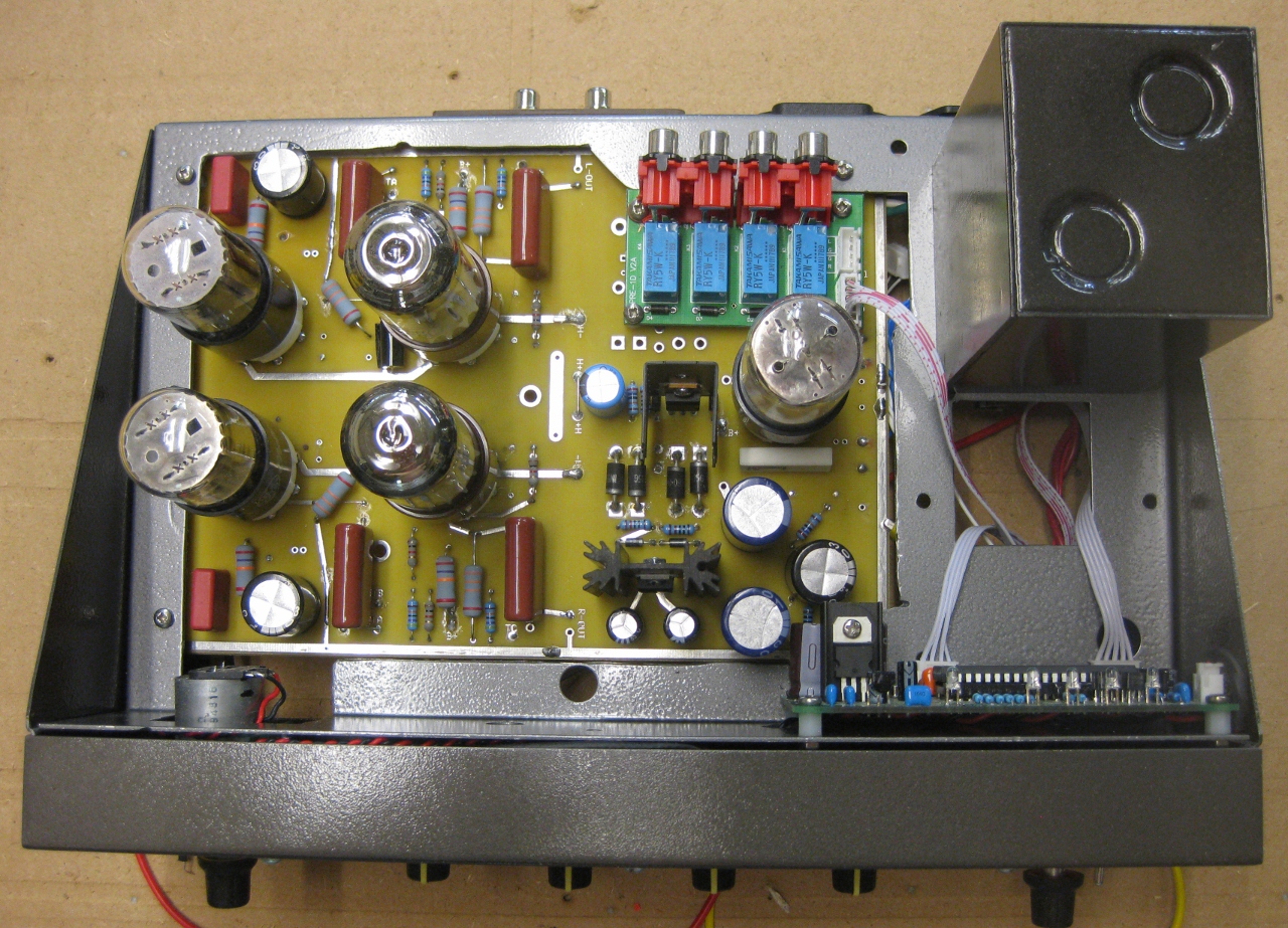

SP9, SP9, SP9...
My Octal SP9 works fine but I can hardly call it an SP9. Across the front are volume, balance, bass, mid, treble. It also has remote controlled volume and input selection.
I modified the circuit for DC coupling between the first and second stage and also the last and final stages. I also modified the circuit for 6SN7 tubes throughout. The regulated power supplies also required changes to accommodate the increased filament and current draw of the 6SN7 stages. And yes, there is plenty of gain with these tubes.
As always, I only ever purchase PCB boards from vendors and build and modify from there.
