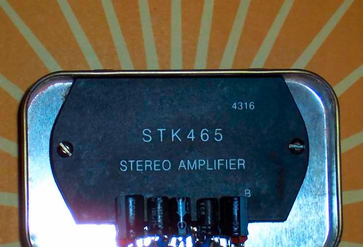

2 Attachment(s)

Quote:
Originally Posted by keantoken (https://www.diyaudio.com/forums/chip-amps/223956-contest-linear-power-amp-mint-tin-class-aa-class-ab-class-post3252447.html#post3252447)
Powerful outputs are too slow to be used at low bias.
Too much bias = swamping clumsy with bias = inefficient = too hot? Is that why this (attachment #2) is terrible? Apparently, some chips aren't suited for mint tins. :)
The chip shown in the attachment wasn't "plan a" anyway. :D
Since I can't vote for myself, I decided to try a few different chip options to learn what works and it wasn't this:

keantoken 23rd November 2012 07:57 AM
Quote:
Originally Posted by danielwritesbac (https://www.diyaudio.com/forums/chip-amps/223956-contest-linear-power-amp-mint-tin-class-aa-class-ab-class-post3252654.html#post3252654)
That's basically it. Our outputs need to be Hfe linear to 2A to drive a 6R load to 9W. What outputs are sufficient? Where is a 2A transistor with Ft>20 at 10mA... Perhaps we could find something in the <80V Vcemax region...
