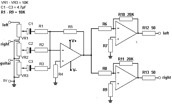

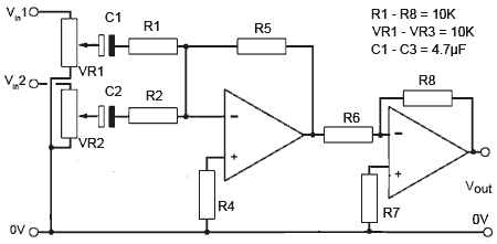

1 Attachment(s)
This schematic is from the Learn about Electronics website. I took the liberty of changing their 3-input mixer into the 2-input circuit you need.
The purpose of the second op amp is to maintain the same phase as the input signal. If you use it, put a resistor of 50-100 ohms between its output and the headphone jack. If you don't use it, make R6 that 50-100 ohm resistor.
The above description is for a mono output. If you want stereo, you'll need to make 2 of these circuits, one each for left and right channels.
You'll need a small power supply also. 12VDC would work fine and be easy to build.

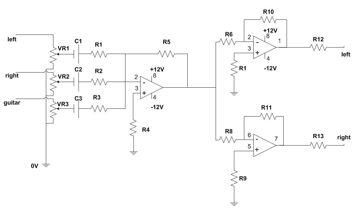

I neglected to say there's a few ways to combine these signals to the headphones.
*Left, right, and guitar on both sides of headphones.
*Left side, right side, and guitar on one side.
*Left side, right side, and guitar on both sides.
Not sure which you want, but each require a slightly different circuit based on the schematic above.
burence73 12th November 2012 03:35 PM
Thank you for quick reply.
These two options are OK:

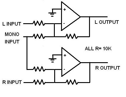

sofaspud 13th November 2012 09:01 AM
1 Attachment(s)
That's a good question; maybe there is a hardware or software solution. I don't think any card I've owned could do it, but then again I've never tried. Anyhow, here's the new schemo. Mono so nothing needs duplicated for another channel.
