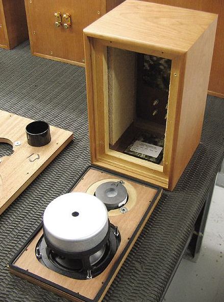

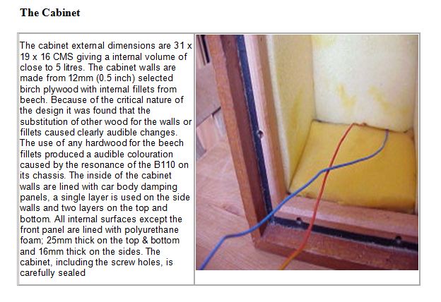

Good article. Since we are ENTHUSIASTS, ORNJ, I'll tell you what I know on this plywood cabinet idea, before you are led astray by the pointless waffle on cabinets that abounds here at diyaudio. Frankly, the advice here on cabinets is CONFUSED to say the least. I had to figure it out for myself in the end. I like to share, because we gotta be getting on with things really. No time to waste.
Troels Gravesen is of the opinion that a good solid braced MDF cabinet is as good as a hard birch plywood/beech battened one. He uses both, although it should be noted that MDF and chipboard are both little better than thick cardboard acoustically.
Spendor and Harbeth both advocate rigid, light and strong 12mm plywood cabinets, preferably in 0.618:1:1.618 golden ratio. Beech Battening is to help construction mainly, and panels can be removable. Doesn't matter much whether it's reflex or closed box. The damping idea is to stick something rubbery (like carpet underlay) on the smaller sides and top and bottom, but strangely, not the front and back. You can mix MDF and ply, the more rigid ply is used on back and front. Add a little bit of fluff behind the woofer to limit box resonances, but no need to overdo it.

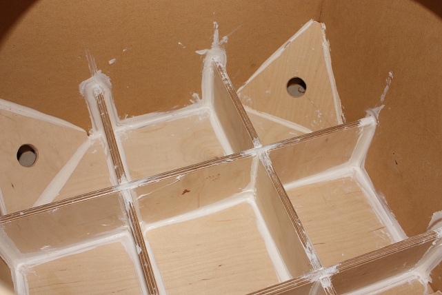

If you use a narrow front baffle and a deep box, the big resonant sidepanels can be braced with the same material as in this Dayton example. That's it really. Usual images enclosed to clarify. Not rocket science. Sorted, I'd say.

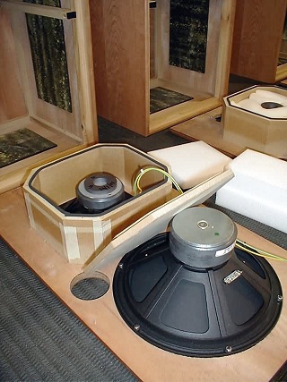

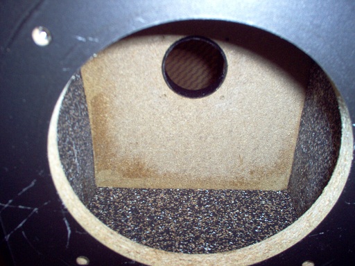

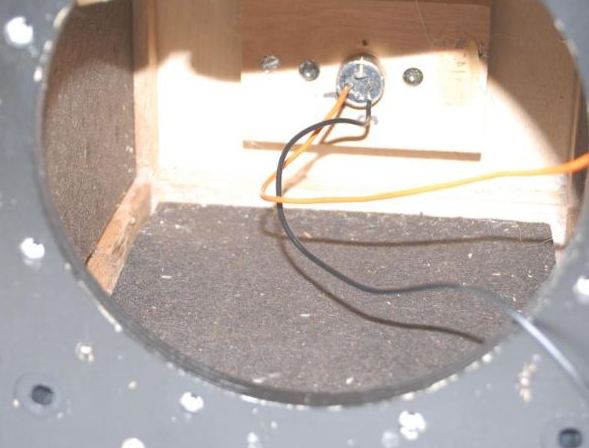

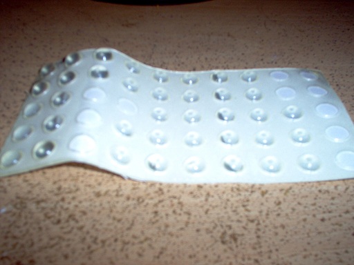

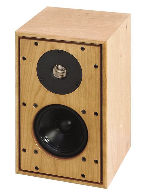

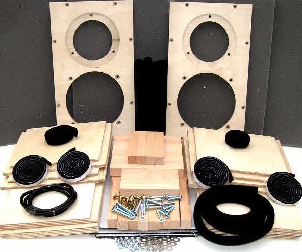

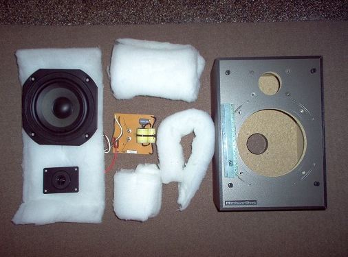

Here's my thread about improving the cabs on some plastic PA speakers. Thinking of some sort of damping like deflex and or damping paint, with one large brace side to side.

It's very enjoyable to read the musings of someone like Alan Shaw of Harbeth. Let's have a look inside a BBC based similar small Spendor Cabinet:
Looks about right. Let's not kid ourselves that birch ply is floppy stuff. It's actually as tough and rigid as you like. Bentwood chairs made of it are incredibly strong for such thin stuff. The idea is to reduce energy storage by keeping things light. An idea that Joachim Gerhard goes along with. I was incredibly impressed with the side damping I applied to a decent little Mordaunt Short closed box cabinet. It gave an openess to the sound that a heap of wadding kills stone dead. Gives you reflex open sound in closed box.

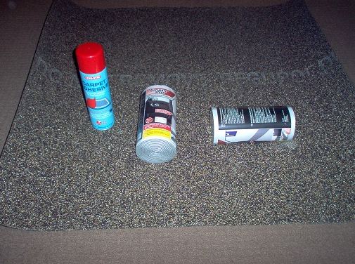

I also was given some cheap IKEA kitchen cabinet door closer dampers (£2!), which work very well as loudspeaker corner mounts. We assume you have taken care of any harshness on the drivers here with suitable crossover design, because a heap of wadding ain't gonna help.

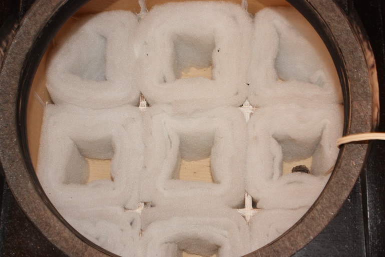

I always like Tinitus' ideas on cabinets too. He's tackling cabinet and box resonance in one fell swoop. It's a good idea to affix wadding to something solid. Turns energy into heat.

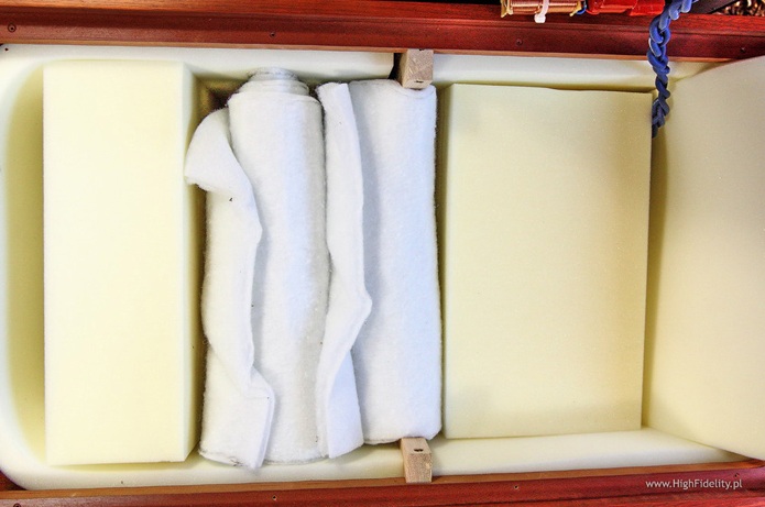

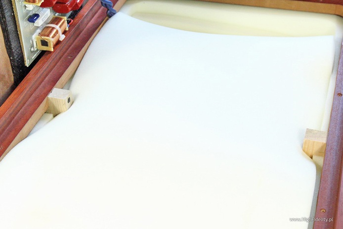

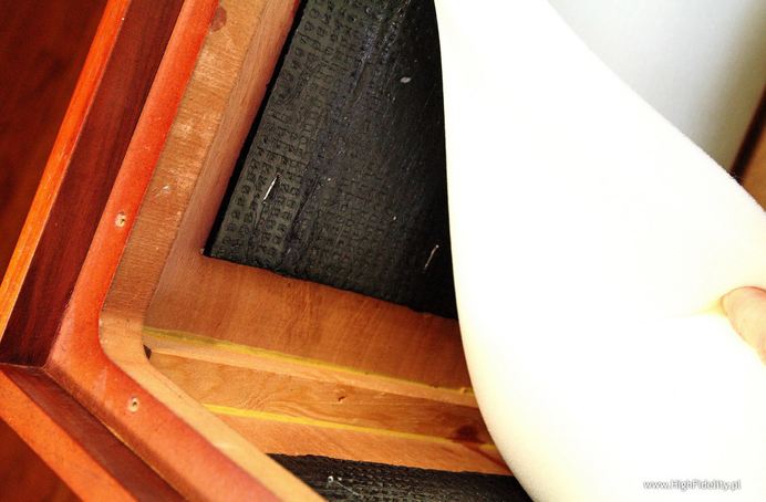

This picture of a big M40.1 cabinet was educational. No fluff at all in the bass cavity. Midrange gets a different treatment.
The second image is Joachim Gerhard's Sonics Anima which has a removable base plate. Made of Bamboo or something these days.

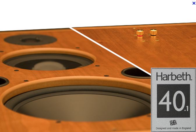

Harbeth Monitor 40.1
Recall Alan Shaw's analogy to a "Cracked Bell" not ringing. The Monitor 40.1 is notable for having almost NO boxiness to the sound. Not quite sure if the brace is glued to the sides here. It's a secret...
There IS some stuffing in the box though. Looser behind the woofer, I surmise. Quite honestly, Harbeth speakers are so good, so lovely, I suspect I would just buy them if I was a bit richer, and abandon diy altogether!
