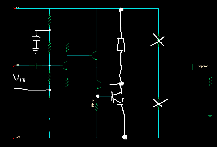

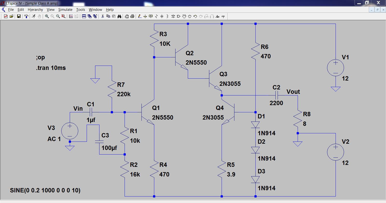

This is my first amp design. Im not new to electronics but I am new to audio amps.

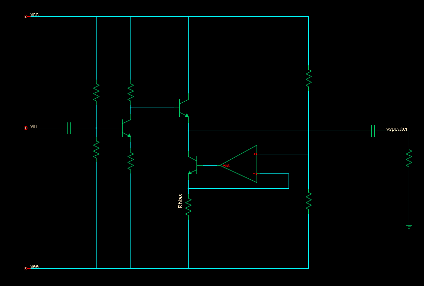

This is just a simple class A amp (schematic attached). The common-emitter stage is a BC517 and the common-collector stage is a NTE261 as is the current source. The bias current is set by Rbias (obviously). Rails are +/-12V.
As you can see the amp is just has through hole components on a radio shack pcb and the transformer is just mounted on the wood. Earth is not connected since there is no chassis shielding (since it's constructed on wood).
Here are some things I noticed about the 60hz hum:
1. Hum amplitude increases as Ibias is increased.
2. There is no hum when nothing is connected to the RCA jacks. (input cap open circuit).
Please advise. I can take any measurement (voltage or current) or signal (I have an oscilloscope).
Fusion916 9th October 2012 03:46 AM
Sorry forgot to attach the pics. Attached now.

DUG 9th October 2012 11:20 AM
Your "R bias " needs a cap to filter out any ac on the lower resistor. Then the current source will be just DC.
Easier to describe with labels on the components. Values would help, too.
Then look at ground current paths.

Fusion916 9th October 2012 04:58 PM

Where would AC come from on the rbias resistor? The gate of the bjt with have a very small ac signal from the opamp (to compensate vds changes), but I don't think that will couple to the resistor right? What cap value will I need? 0.1uf?
Also, I am looking at grounding paths by reading previous ground loop threads, but would also like some direction.
The component values are 10k/1k on the CC stage (for a gain of 10), the bias value for the opamp is about -10.5V to get a ~1.5V drop across the resistor.
The input stage I believe is 20k to ground but I forget the top resistor. It's biased to achieve ~1.2V at the output.

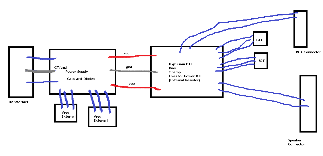

Mooly 9th October 2012 05:59 PM
The frequency is a good clue. Noise from the PSU is at twice line frequency (due to action of the bridge rectifier and all those half cycles :)) That why it sounds a bit harsh. A pure 60Hz hum at low levels can be pretty inaudible.
I'm going to point you to this thread and you should read it all as it will give you a good insight into the problems. Remember every piece of wire that passes current develops a volt drop across it. That applies even to the thickest wire. And that small volt drop matters because if you connect two points in a circuit along that wires length they actually have that voltage difference between them. Now imagine that wire is in fact the ground and those two points are your input ground reference point and the feedback return. When you short the input to ground the amplifier actually sees an AC voltage as being present and amplifies it. The AC voltage is caused by the huge (in the tens of amps range) charging pulses of the bridge rectifier which only conducts briefy for a few degrees on each cycle to bring the reservoir caps back to full supply voltage.

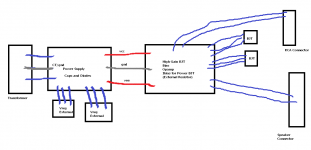

Fusion916 9th October 2012 11:34 PM
2 Attachment(s)
Quote:
Originally Posted by Mooly (https://www.diyaudio.com/forums/solid-state/221207-help-60hz-hum-ground-loop-schematic-attached-post3195286.html#post3195286)
I'm only doing half-wave rectification so it it's from cap charge pulses it would definitely be 60hz right?
http://www.diyaudio.com/forums/solid...ml#post1624677
I understand what you're saying but I'm not getting a general principle as to where the problem can be in my circuit or what ground connection I need to improve and where.
I've attached my physical tolopolgy. Please take a look.
Will it help to physcially seperate the amp stage and the power supply more? Will it help to use thicker vcc/vee/gnd wires (less resistance). Will it help to beef up the grounding on the power supply? Where is the best place to ground the RCA connectors and speaker connectors? Thicker wires there?
