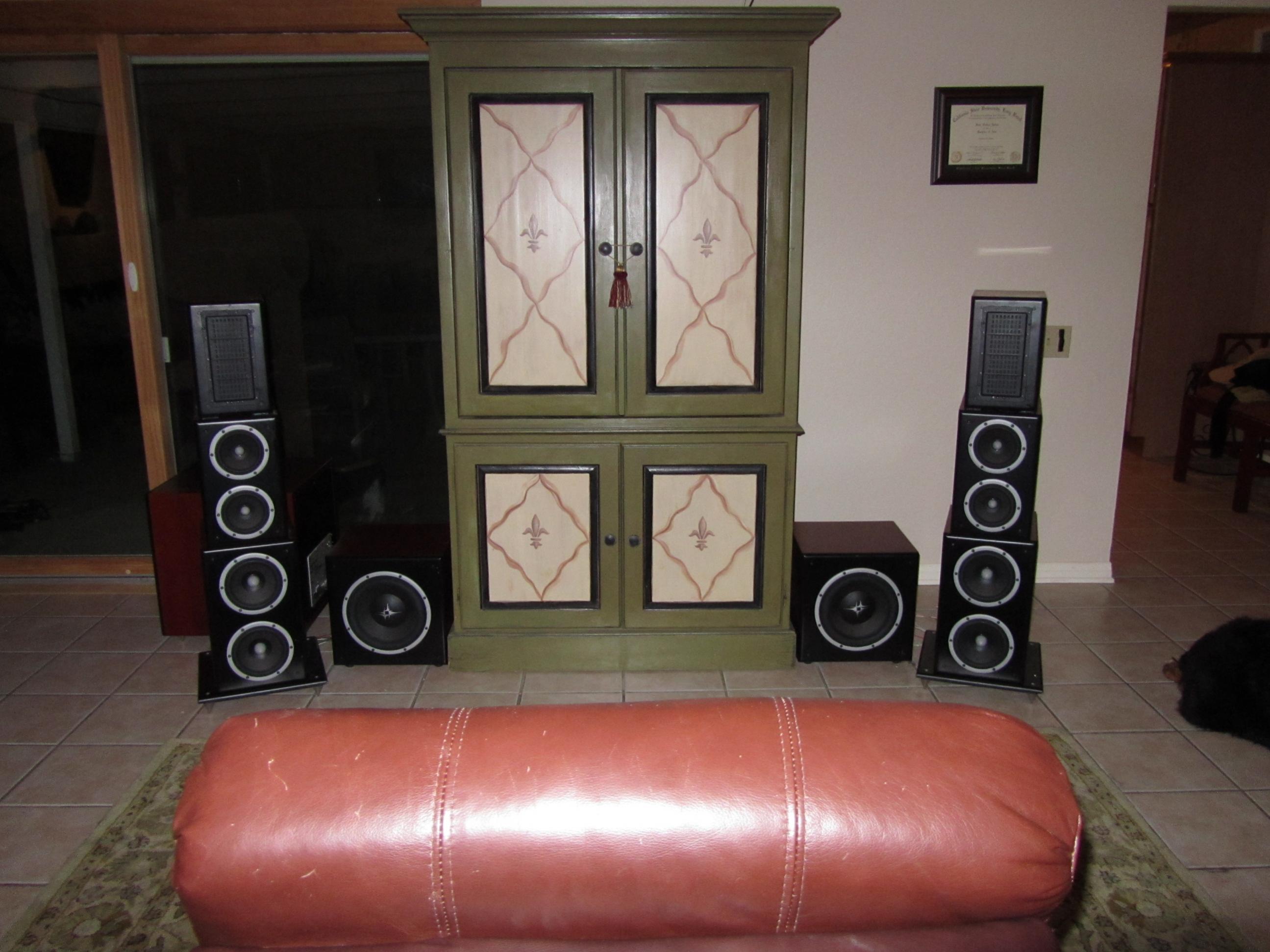

Remlab 15th September 2012 10:28 AM
1 Attachment(s)
"Farfield" is a relative term too, I guess. Here's my limited dispersion setup. Neo 10 dsp'd flat at 60", on axis(Of course). All monopole..
