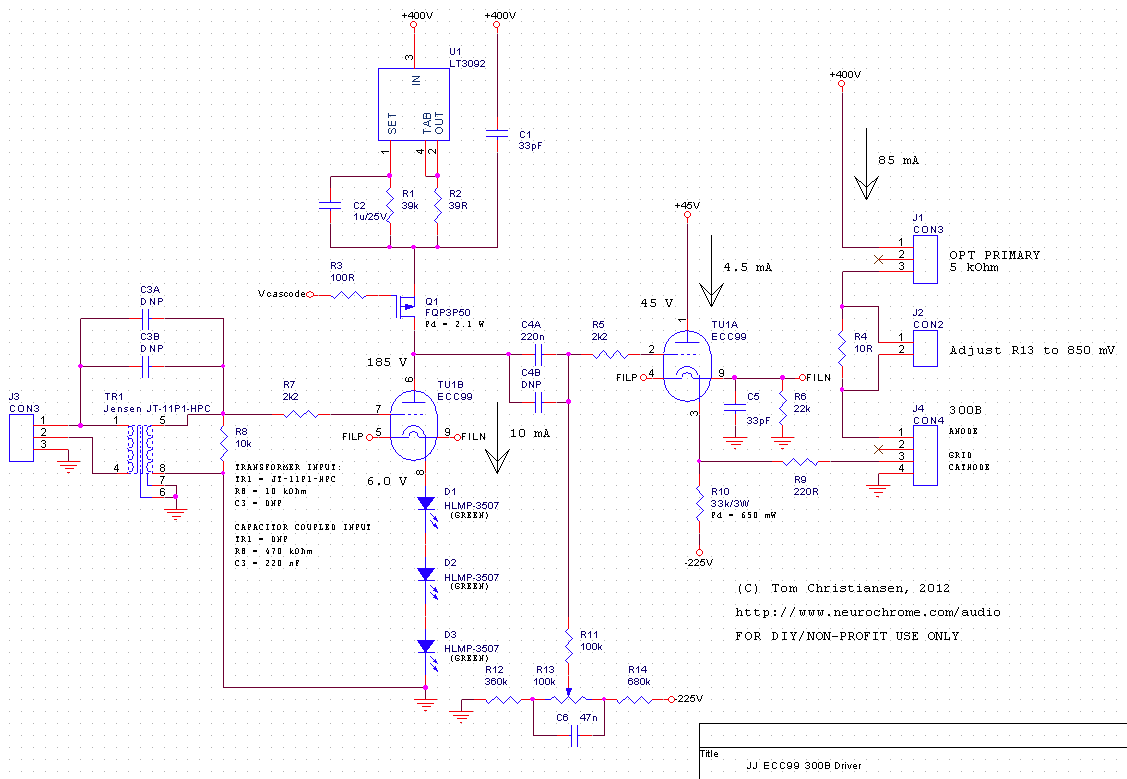

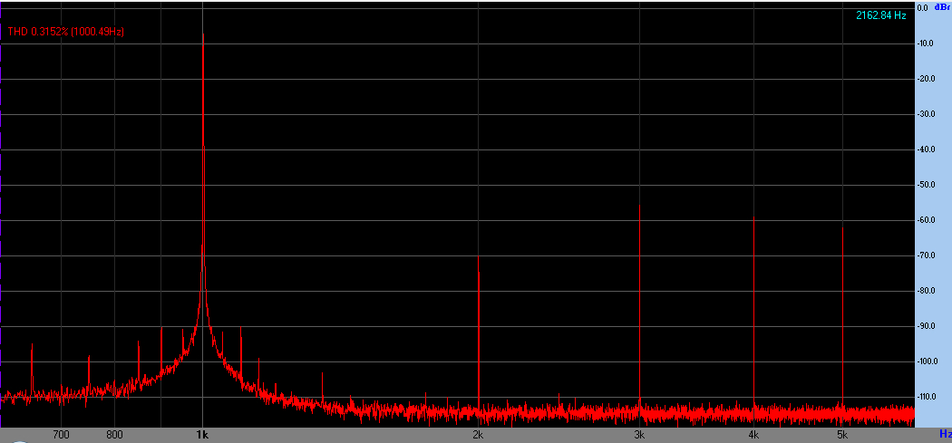

Those of you who have followed my posts for a while know that I've been perfecting my 300B amp for a couple of years now. I think I've finally reached Audio Nirvana.
The main challenge driving a 300B is that the driver will have to swing 160~180 Vpp, cleanly. The ECC99 from JJ fits this bill very nicely. It's a medium tube ( = 22), in current production, and reasonably priced ($15/EA). I've tried several other tubes - 6SN7, 6SL7, d3A, etc. - but they either can't swing 180 Vpp cleanly or can't provide 180 Vpp at all at reasonable bias points. The 6SN7/6J5 comes close, but the ECC99 is much lower THD.
I tried several circuit topologies and ended up settling on using one ECC99 per channel. One half of the ECC99 provides a CCS loaded, LED biased common cathode amplifier stage with a gain of roughly 20 V/V. The other half of the ECC99 is rigged as a cathode follower driving the 300B.
The high gm of the ECC99 (9.5 mA/V) ensures a low output impedance of the cathode follower (Zout = 100 ohm). Hence, the driver's output impedance is dominated by the grid stopper on the 300B.

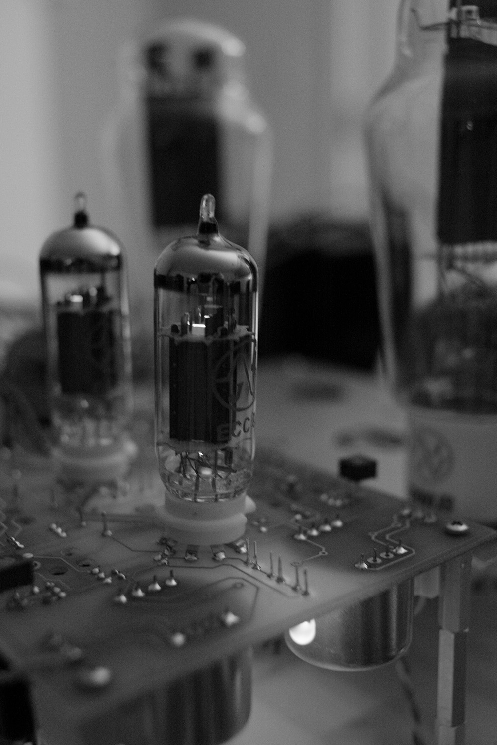

My first prototype has been playing in my living room for a few months while I've been tweaking it. I'm likin' it. I plan to offer boards for this amp sometime in the fall.
~Tom

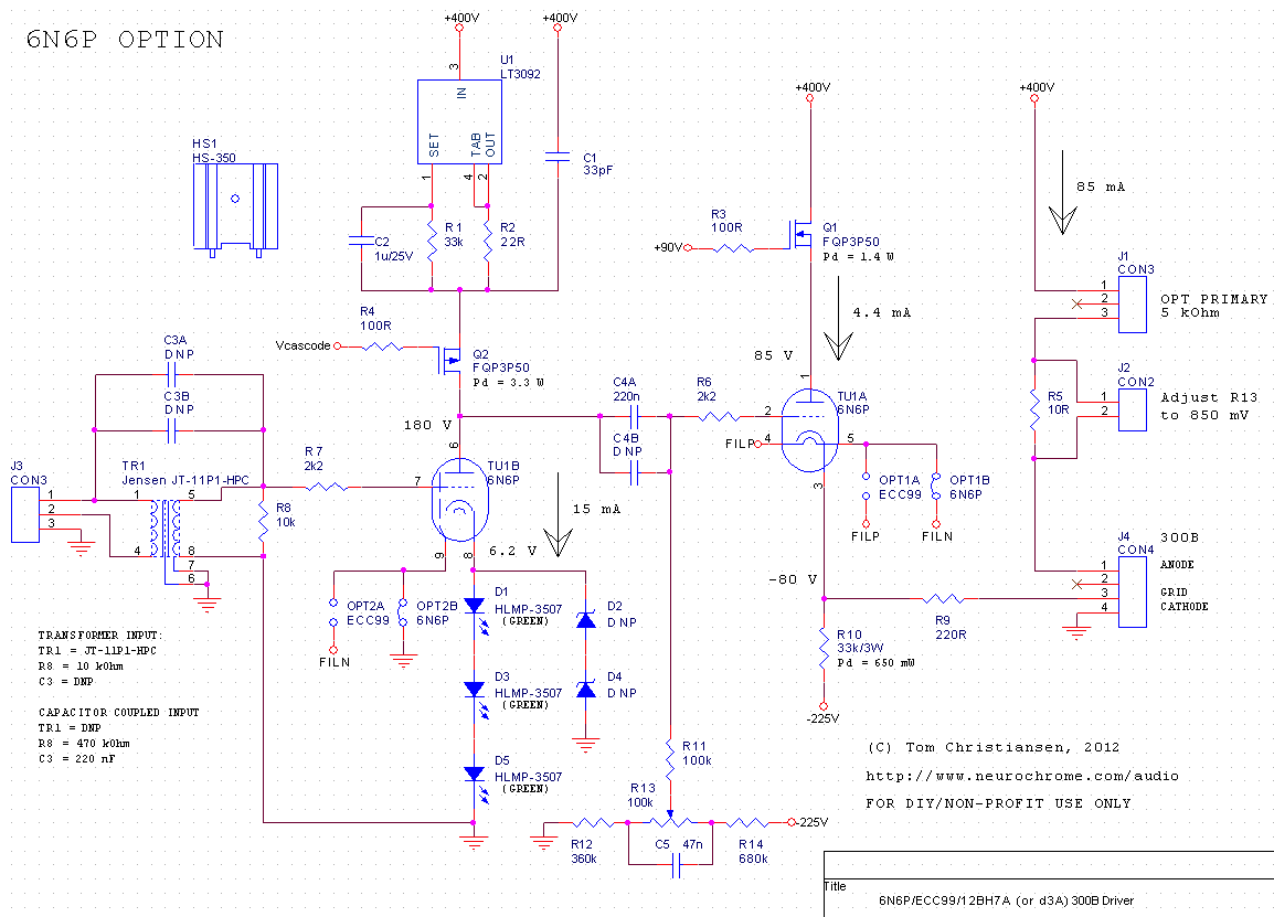

HollowState 19th August 2012 11:55 PM
I assume you call it a death trap because of the exposed circuit. And although I've never owned or used one, have you tried the Russian 6H30 dual triode? It seems like it should also do the job according to what I've read about it.
Cassiel 20th August 2012 01:02 AM
And the black and white picture adds that final extra of morbidity. Not long ago I thought about calling one of my amps 'Electro-Cute'. It was cute and dangerous.
tomchr 20th August 2012 01:31 AM
Quote:
Originally Posted by HollowState (https://www.diyaudio.com/forums/tubes-valves/218217-deathtrap400-pretty-damn-300b-amp-post3132929.html#post3132929)
My prototypes are usually built point-to-point on a piece of plywood. Hence, the DeathTrap name... My present amp isn't complete, obviously. It'll need an enclosure and such.
I have not. A quick glance at the plate curves reveal that it would be a good candidate as well. The is a bit low (15) so it'd take a preamp with some oomph to drive a 300B into clipping. But it could be interesting to try.

Bigun 20th August 2012 01:44 AM
You use a CCS load for the common cathode amp stage, why didn't you use one for the common cathode stage instead of R10 too ?
or if you prefer,
Why didn't you use a resistor load for the common cathode amp stage instead of the more complex CCS ?
kevinkr 20th August 2012 05:56 AM
Quote:
Originally Posted by Bigun (https://www.diyaudio.com/forums/tubes-valves/218217-deathtrap400-pretty-damn-300b-amp-post3133014.html#post3133014)
or if you prefer,
I'm assuming you meant cathode follower.. Not speaking for Tom here, but the load resistor R10 is quite large compared to the internal cathode source impedance, the CCS would provide less benefit here, and if it failed open would take the 300B with it.
There are at least three reasons I can think of to use a CCS as a plate load in a common cathode stage, one is to maximize gain which is needed here, another is for the good linearity it provides, and finally it reduces the required driver supply voltage required rather significantly for comparable performance with a resistive load.. Another obvious advantage of a CCS is the high PSRR it will provide.

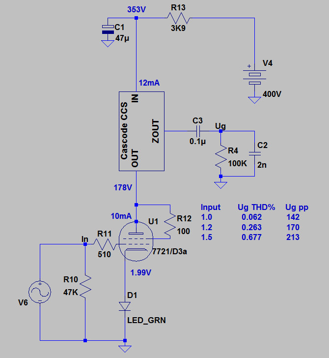

Vincent77 20th August 2012 09:21 PM
Quote:
Originally Posted by tomchr (https://www.diyaudio.com/forums/tubes-valves/218217-deathtrap400-pretty-damn-300b-amp-post3132877.html#post3132877)
What's wrong with the D3a? It can swing more than 200Vpp...
wrenchone 20th August 2012 09:44 PM
6N6P for driver?
kevinkr 21st August 2012 05:35 PM
Quote:
Originally Posted by Vincent77 (https://www.diyaudio.com/forums/tubes-valves/218217-deathtrap400-pretty-damn-300b-amp-post3133909.html#post3133909)
I use them to drive GM70 which they do quite well. I have future plans for an IT coupled D3A/300B amp..
tomchr 21st August 2012 10:42 PM
Quote:
Originally Posted by kevinkr (https://www.diyaudio.com/forums/tubes-valves/218217-deathtrap400-pretty-damn-300b-amp-post3133136.html#post3133136)
That sums it up quite nicely, actually. On the common cathode stage, I used the CCS load to maximize gain and minimize THD. I tried a CCS on the cathode follower as well but the difference (both in measurements and listening tests) between a CCS and the 33 kOhm resistor was negligible. I figured a resistor beats a CCS on price and complexity any day so I stuck with that.
~Tom
