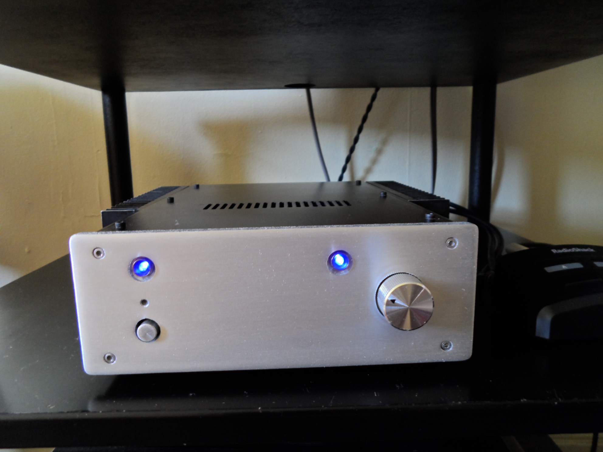

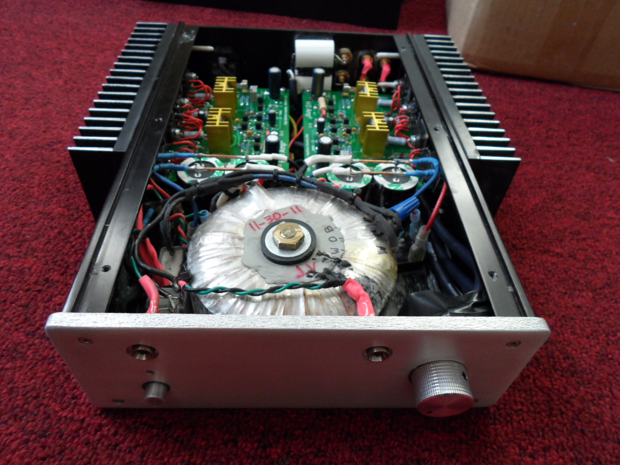

sound quality? well, first it depends on the design of you amp, if money is not a problem for you then I will go for one case for amps and the other case for power supply. I have seen people using four chassis for a stereo amp. and I have seen amps using one chassis that are excellent too. in my case I went for one chassis to save money and I also wanted to build an integrated amp small but at the same time not sacrificing quality. take a look.
lanchile 29th July 2012 10:15 PM
2 Attachment(s)
This is my diy in one small chassis.
