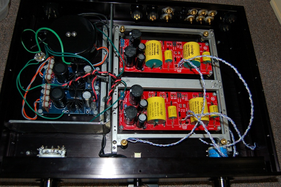

Balanced B1
Hi.
I also bought a DacMagic with balanced outputs and am building a balanced B1
from imported boards(see pic). You'll need two stereo boards plus a 4-gang pot.
I look forward to using this combo to drive a Forte power amp with balanced inputs.
-Chas

Just finished final assembly,
Everything works, exept for a defective 4-Gang Attenuator (from China on eBay) I am contacting the vendor to see about a replacement, but it's way past the 14day return period...
I wired it up with a one stereo pot on each channel, and the sound with CD's is GLORIOUS!

Did you try the passive approach, without the B1 buffers, with only the ganged attenuators between the DacMagic output and the power amplifier input?
Thanks for the kind words.
Nope, I was concerned about input/output impedance, so I went with the buffered approach.
The sound is quite nice and I don't find myself wanting to turn down the volume as much as before(lower distortion?)...
