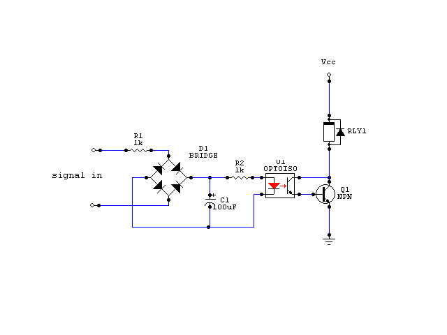

Hi all,
just read an article in a magazine about a simple DC protection...
it looks like in the picture.
any comments welcome...

Speaker voice coils can receive DC components in both polarity. This is the reason, why I don't prefer this topology as DC protection.
The best protection circuit topology for DC coupled amplifiers is that one from TA7317P (if no longer available, easy to clone with discretes).
TA7317P Datasheet pdf - PROTECTION CIRCUIT FOR OCL POWER AMPLIFIER AND SPEAKER - TOSHIBA.
Much more better is an AC coupeld mode with the big high pass electrolytic capacitor in series to the speaker, because I don't need a relais contact in series to the speaker (only for new amplifier diy projects, unfortunately not for modify of existing DC coupled amps).
