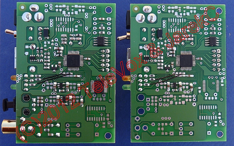

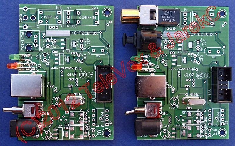

I would like to present my new project "USB to I2S/SPDIF asynchronous mode conveter 24bit/96kHz based on TAS1020B"
I started this project about a year ago. It is now close to completion.

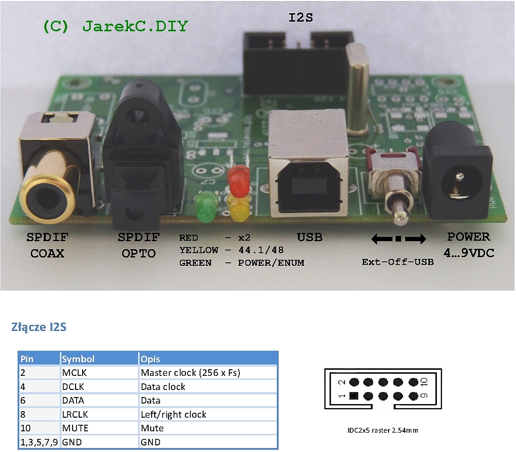

The project was divided into several stages:
Stage 1: (READY)
- USB to I2S converter (fsample 44.1kHz,48kHz,88.2kHz,96kHz 24bit)
- Master Clock = 256Fs
- powered from USB or external power supply
- Master clock generated by TAS1020B from 6.000000MHz crystal
- 3 LEDs for indication an operating mode
Stage 2: (READY)
- USB to SPDIF converter (fsample 44.1kHz,48kHz,88.2kHz,96kHz 24bit)
- Wolfson WM8804 SPDIF transmitter
- Outputs: COAX, OPTO, AES/EBU (optional)
Stage 3: (IN PROGRESS)
- USB to I2S/SPDIF converter
- two external master clocks 22.5792 Mhz (for 44.1Khz and 88.2kHz) and 24.576MHz (for 48Khz and 96 Khz)
Stage 4: (PLANNED)
- galvanic isolation for USB Bus (ADUM4160)
Bellow schematic and photos of first board (I2S and SPDIF versions).

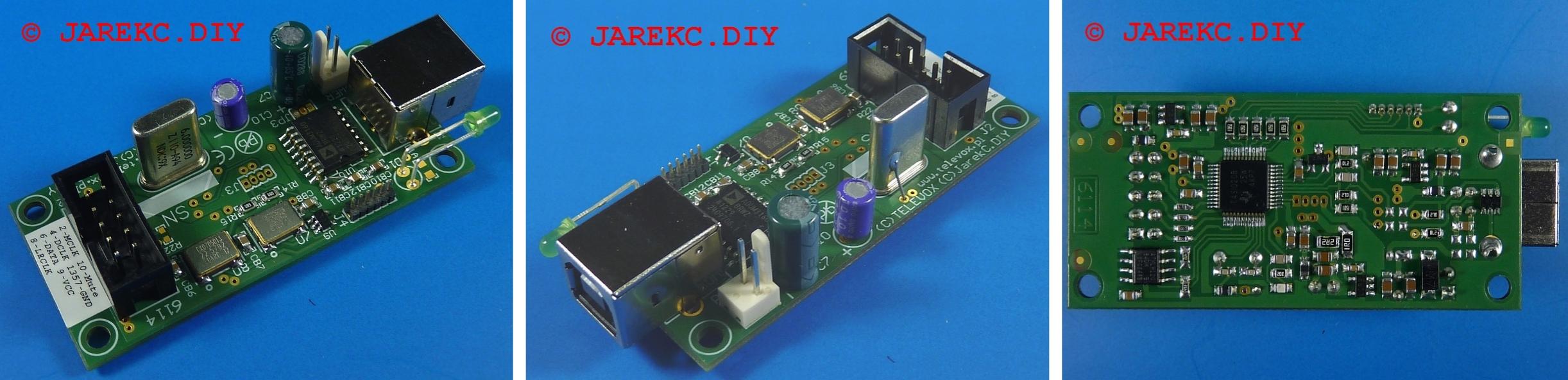

I designed an additional PCB layout with galvanic isolation (ADUM4160/3160).
The PCB is mounted instead of USB connector.
On the new PCB there is new USB mini connector.
TAS1020B controls the signal PIN of ADUM4160.
ADUM can be powered from 3.3V or from external power supply.
Bellow schematic.

The PCB is ready for AES/EBU-XLR output.
Additional parts for this option:
-XLR Connector (mounted outside the PCB)
-PE65612 transfrmer
-DS26LV31 driver
-110 Ohm 0805 resistor
-100nF 0805 capacitor

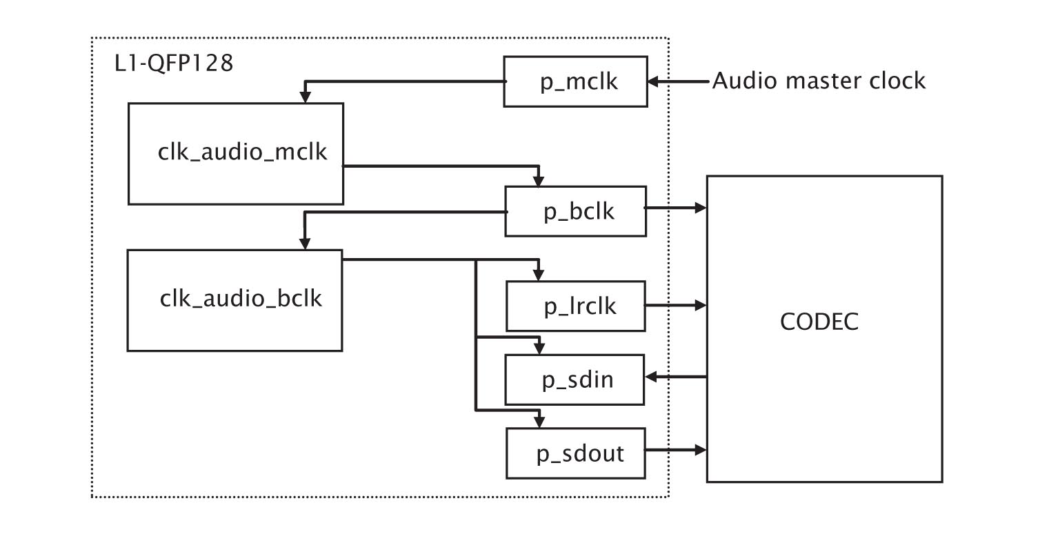

As I wrote, it is an interesting project. But why mini-USB? People might have invested on USB A-B cables...
Is it supporting USB Audio 2.0 like the XMOS Reference Design?

TAS1020B have USB Full Speed USB Interfece (12Mb/s) and supports only USB Audio Class 1.0
I plan to design new PCB with isolation and fitted in Harmond Alu case.
I also plan to design version with USB Audio Class 2.0 based on TI DSP C5xxx.
In XMOS I/O pins are reclocked with 400Mhz, this I do not like.

Look at Figure 8 at page 24 (posted below) to see that I/O ports in XMOS processor are driven by external audio master clock (one of two available - depending on incoming sample rate). 400 Mhz is the running frequency for the processor's internal threads. Moreover, I2S signal's retiming should not be done using a multiple of 44.1 or 48 KHz freq.? .. like 22.5792 || 24.576 Mhz OR 45.1584 Mhz || 49.152 Mhz. How above frequencies would fit in 400 Mhz or you think that XMOS has implemented some sort of ASRC at outputsJarekC said:In XMOS I/O pins are reclocked with 400Mhz, this I do not like.
Perhaps you should check this document first before saying such an error:
Hi.
You are not right.
Look at:
https://www.xmos.com/download/public/XS1-Ports-Specification(X1373A).pdf
In a description of the clock block in section 3.4 you find:
"Note that any external clock is itself clocked-in using the 400 MHz core clock."
Confirmation of this can be found here (XMOS technical forum)
XMOS Support Board • View topic - External clock
Respond of Larry XMOS employee:
Another confirmation of this is that SPDIF out on XMOS reference board is reclocked with MCLK (U1 NS7SZ175 chip)"Yes, any external clock is resampled to 400MHz
If you tie I2S signals BCLK LRCLK and DATA to a low-jitter external
clock on the XMOS device, this will introduce a jitter in the order of
one to two 2.5ns (400MHz) cycles"
Best Regards
JarekC
