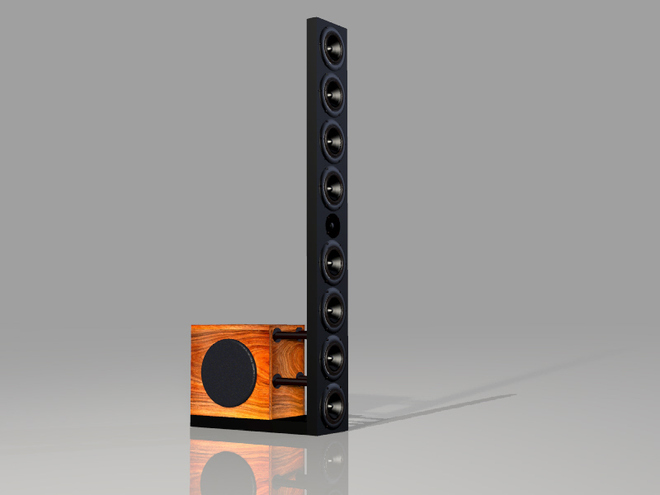

Here is a project that I have been working on for a while. It is an open baffle "hybrid" two-way design. Open baffle part is an 8" fullrange driver, there is also a 12" sub in a sealed down firing cabinet.
Bla bla bla......here is the build. Comments welcome......
Here is a 3D model of the finished product.

Notice the sub doesn't contact the tower anywhere. This is to prevent any vibration that the sub cabinet might have from being transmitted to the tower.

Curious, are you using one or two downfiring subs?
Zilla
:D
One 12" sub per tower.

I'm curious, what inspired you to make this design? It's very well thought out with regard to the overall look, elegant curves, details (i love how the sub is separate from the baffle and sits in it's own nook), how the back of the driver just clears the top of the sub, etc...
