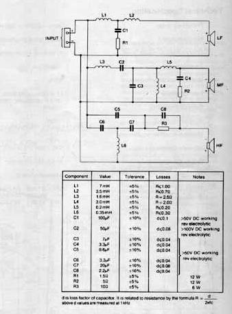

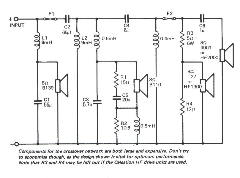

I've been using the crossover below with KEF B139/B110/T27 drivers for many, many years in a DIY ETI transmission line cabinet and I'm basically very happy with the sound except the midrange has always been too forward for my liking - mostly voices are too strident and a bit 'cuppy'.
So I've also been using a 15ohm resistor in series with the B110 midrange driver and this seems to bring a better balance. Now I know a single resistor is not ideal so I bought some 2.2 and 18ohm resistors today to put in a proper L-pad (B110 is 7.8ohm).
But looking at the crossover again it occured to me that maybe removing the 5ohm and 12ohm tweeter resistors might bring about a similar effect without introducing more components. Or perhaps I could alter some of the midrange network which the instructions say 'reinforces output below 600hz'. Which is the best way to go? (PS I do not use the HF2000 supertweeter section of the circuit as I use the T27 alone.)

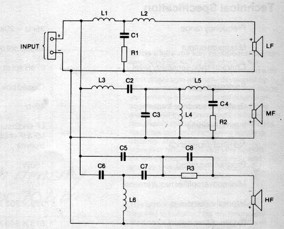

2 Attachment(s)

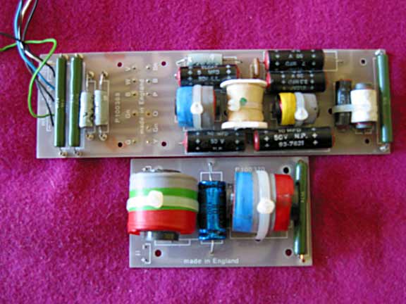

The crossovers are very messy and difficult to work with so I've decided to completely rebuild them. Jantzen Z-Superiors in the tweeter section and Crosscaps in the mids and bass.
I've also seperated the crossover into a tri-wire (schematic attached).
I'm wondering if the Butterworth tweeter section of the KEF 104aB would be an improvement over the one I use, as it seems to be regarded highly by 104 owners. Would there be any problems substituting it into my crossover (which seems to be very similar to the P. Atkinson 'State of the Art Loudspeaker' crossover) ?
Dave1027 28th August 2011 04:16 PM
Just put a resistor in series with the 0.6 mH coil on the midrange and call it a day.
Mr. dB 28th August 2011 05:08 PM
Maybe increase the 0.6mH inductor to 1.0mH or so?

1 Attachment(s)
closer view of the CS7 crossover:

Hi Metako,
The KEF Constructor Series CS7 was based on the commercial Cantata which used the B139/B110 plus the more expensive T52,a refined version of the earlier T15.
I used the T27 which is marginally less sensitive but I prefer a less upfront treble balance anyway.
Kef used the 3rd order low pass to deal with the colouration caused by the well known peak the B139 exhibits at the upper end of its operating range.
Similarly the mid section has a 24dB upper rolloff to attenuate the B110 breakup nodes in it's upper range.This does help reduce the infamous nasal quack that the B110 has often been accused of.
I have tried the SP1003 version of the B110 and felt it required a larger value of series inductor I/L/O 1.6mh,to equal the response of the smoother SP1057 midrange.
2mH-2.4mH would be a good starting point.
KEF were very specific about abiding by their recommendations if results were to be guaranteed.This include the use of cored inductors and reversible electrolytics eg ALCAP-
"The combined R of L1 and L2 seems quite high at 1.7ohms"
My understanding of their recommendation is "less than 1 ohm","less than .7 ohm" which is easy to achieve with eg.high power iron dustcore inductors.My experience is that a little series R doesn't do any harm anyway as in this case the B139 has quite a prodigious output regardless.

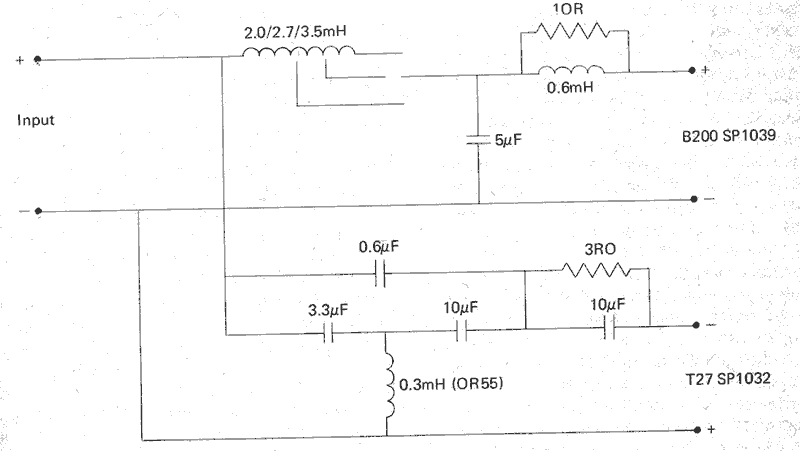

Hi Eanee. Thanks for those clearer pics. So the T27 will work OK in the CS7 circuit without modification. I wonder if the T27 tweeter section of the 104aB crossover (see attachment) would be a better to use with the CS7 mid and bass section. I'm slowly learning how to use crossover simulation software so hopefully soon I'll be able to see how they would work together. Thanks for the suggestion re the need for a larger series mid inductor too.
