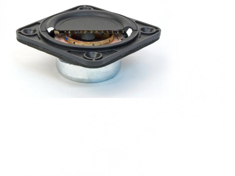

It will be interesting to see how this turns out, it seems like an interesting variation of the "flat cone" drivers out there. I'm guessing that not letting it produce bass frequencies might be more beneficial at this stage while the technology is relatively new. They forgot to put damping material between the disk and the pole-piece, inside the voice coil area ;-)
Their bass driver doesn't seem radically different aside from the "de-modulation rings", which seem to replace copper rings in other woofers...?

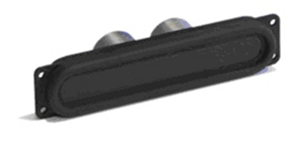

Looked a bit like : (but will a full length magnet and voice coil)
This is a HARP (High Aspect Ratio Panel) BMR
rgds, sreten.

Is that picture of the new driver from HiWave? I know they have a few BMR drivers out now (HiWave: sensation innovation), but they're going to release some new models shortly. I believe those will include 3.5" and 6" round, as well as 2 oval ones that look virtually identical to what you posted.
I have a preliminary PDF of them, but it's too big for an attachment. If anyone is interested PM me and I'll send it to you.
