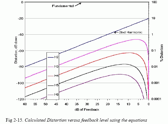

I saw this comment at an other tread. This is not the only I have seen claiming that low amount of (global ?) NFB will increase the level of higher order harmonics.
One documented article can be found here: http://www.passdiy.com/pdf/distortion_feedback.pdf
There is results (at page 10) about an experiment done with class A SE Mosfet amplifier showing the increase of higher order harmonics with low amount of NFB.
I made my own test with a 15 W UL-connected tube amplifier to see if I can see this phenomenon.
I made the test with constant -3 dB (7,5 W) output level. Global NFB was adjusted from 0 to 22 dB and the level of harmonics up to 7th was read on each NFB level.
The result is that my experiment did not show such behaviour. Instead the level of all harmonics decreased when the NFB was increased.
The results are here:

Why this difference ?

It is going to vary based on the harmonics generated by the device without feedback.
Feedback modifies the terms, so it will vary depending on the device used.

Thats exactly what I observed, too
Even little Feedback decreases the overall distortion at such a rate, the little bit, which could be added is insignificant. Thus, IMHO Feedback is and has always been essential for a good power amplifier.

Using just a 1kHZ sinewave as a test signal may not show a few things. At supersonic frequencies where the feedback is likely to roll off, the distortion spectrum may get ugly. Now that so many program sources are digital, imperfectly turned back into analog, and may contain a small amount of this supersonic or even Rf energy, it could be important to look at. Also there's intermodulation distortion that gets generated by any negative feedback "corrector" circuit (usually the front end). But the person who found that 6dB of neg feedback is worse than 0 or 20dB may have done a sloppy job of setting up the measurement process. Not everybody realizes all the variables at play.
Personally I'd rather have as much as 0.2% harmonic distortion than to have high I.M., any chance of slewing related distortions exasperated by high feedback, any chance of overload related problems or phase margin issues... My own tests showed higher order distortion product went up when neg feedback was increased. With no feedback only the 2nd and 3rd harmonics were above the noise floor of a $30,000 HP spectrum analyzer. I'm sure this varies with topology and a few other things.
With tubes, the only place I ever use neg feedback is in the output stage when it's a push-pull topology, and I use as small a loop as is practical. Part to minimize crossover distortion, and part because the output stage is driving the substantially reactive load of the speaker. It may be better to have a lower output impedance for driving such a reactive load, or not, depending on all the variables.

1 Attachment(s)
Hello
There is this graphic about nfb vs thd.
Bye

wow, a very interesting measurement. It reminds me that I read somewhere else another person had looked at a solid state Class AB output ad also found that any amount of gnf was good and the more of it the better. In other words, there are real life situations where measurements don't match the theory of simple topologies.
I also notice that despite Nelson's article on gnf he consistently uses gnf in designs that I've seen (e.g. Zen, F5) so again, there's more to gnf than theory.
SY 20th June 2011 02:31 AM
A theory is valid as long as its axioms are understood. The "increasing order" stuff is true for pure square law devices which tubes are very much not.
