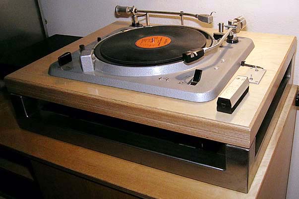

I just took delivery of this SP-10 mkII. To be fair to the unit I want to insure that all essential restoration steps are taken. In that regard I am posting this to invite any and all commentary relevant to this model.
Plans are:
1) fabricate a suitable plinth from Baltic Birch ply (working on that drawing now)
2) replace electrolytic caps in the SH-10E with new
3) disassemble and examine mechanical parts, main bearing in particular, renew worn parts as may be needed
4) mount a high quality tonearm and cartridge.
OK item 4 may be debatable. I plan on using my Zeta and a wood bodied DL-103R with SS FL re-tip. The Zeta is a very dynamic and lively sounding tonearm with excellent detail retrieval capability. Having heard this arm and cartridge on my TD124 mk1, I am familiar with its sound. Now to hear the same arm/cartridge on the SP-10 mkII should make for an interesting comparison.

SoundFountain has a useful page specific to the SP-10 mkII and mkIII. There are also some comments about plinth building for the deck. Among the commentary there it suggests to avoid use of MDF and Corian. I wasn't planning on using either. Just noting. On that note, I presume there is likely some good discussion potential related to material choices for this deck. I'd like to invite that. Why one material and not another. Should we use metal? Should the plinth be massive or light? What are the effects of either?
I also have a 2 inch thick slab of slate which I could cut to suit this deck, but first I'll try something in a multi-layered Baltic Birch build-up because I don't hear too many, if any, negatives about using this material for this application.
Some observations. At this point I just have the deck sitting on the table as pictured. Except that I have removed the diy shipping bracket (piece of plywood over the motor) and installed the platter. After hooking up the SH-10E and powering it up, I have observed that I have three speeds and a strobe that lights steady and strong.
The unit starts and stops its platter quickly and silently. Smooth. I'm Impressed by its on/off action.
I guess that means that the mechanical brake is still inside and in good adjustment. And I suppose it means that the overall health of the motor and electronics isn't bad.
In fact I'm sure I could simply drop this unit into a suitable plinth, mount and align a tonearm/cartridge and begin playing records. However I think I want to make sure the unit is in good calibration before doing so.

Yeah, the great thing about the SP-10 is that you can brush the record off while it is playing and it doesn't miss a beat. It's the most under-rated turntable in the world. In the proper plinth it will better any turntable currently made. Even better is the Mark III.

No doubt. If only one knew what a "proper plinth" was :)
At the time when i had an L07 and hated it, a friend with an SP10 compared the two and pronounced the SP10 the undisputed winner. Slightly more surprising was that before long he replaced his SP10 with an LP12 :bigeyes:

A PLINTH - TURNTABLE BASE for TECHNICS SP-10 mk2/MkIII Direct Drive -SL-1000 DD Professional Studio Turntable
Scroll down to Albert Porter's plinths. That combination smoked the Walker Proscenium Super Duper. The latest iteration can be seen here:
AudiogoN Forums: Albert Porter's System
John
analog_sa 13th June 2011 03:52 PM
These plinths appear really great and i agree with his design philosophy. Only the claim that high mass turntables are somehow less sensitive to tonearm quality is a bit baffling and against my experience.
