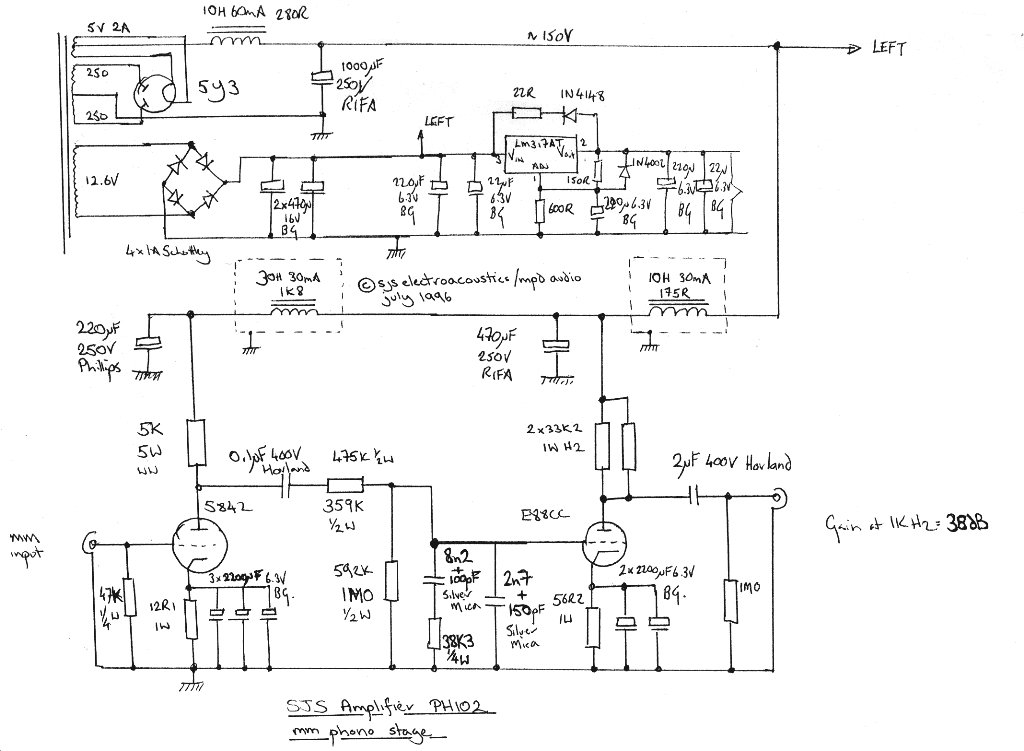

I'm open this new thread to fine tune my Puresound P10 phono RIAA, also I would like to know output impedance of first stage? schematics & real unsoldered components values as follows:
Left channel
R1 329K CADDOCK TF020R
R19 998K CADDOCK TF020R
C9+C8 .00270 paralleled .000106 = 2.806nF teflon film & aluminium foil
R17 38K9 CADDOCK TF020R
C7 .006 paralleled .0022 = 8,2nF teflon film & aluminium foil
R18 99R9 SHINKOH
Right channel
R19 999k CADDOCK TF020R
R18 99R9 SHINKOH

Based on the info here: On 'RIAAEqualization Networks´ and following Lipshitz calc I devised a simple simulator. http://forums.melaudia.net/attachment.php?aid=1301
Excluding the effect of first stage output impedance and also the miller of the second stage, my initial test would be to use:
R17 = 38K9 // 478K = 35973 r
C9//C8 = 2.7nF // 106pF // 220pF = 3.026nF
C7 = 6nF // 2.2nF // 640pF = 8.84nF
Let me know what real values you can get so we can choose the best options.
Of course, all must be recalculated if there is significant output impedance on the first stage and we should also consider miller effect of second stage (I do not know if there is any "forward" miller from the first stage also).

Joined 2006
Well, those values are so high that if I try to include them im my simulator (excel calculator), It produces big errors to riaa.
The highly tuned design in attach is very similar to the Puresound, appart from the plate resistor that is 5k against the 120k in the Puresound.
It seems to me this schematic also disregards the effect of the the first stage output impedance so I would have a go with the values already determined.
Merlin... The circuit you need to tune is already built ?
We need some subjective listening impressions now.
