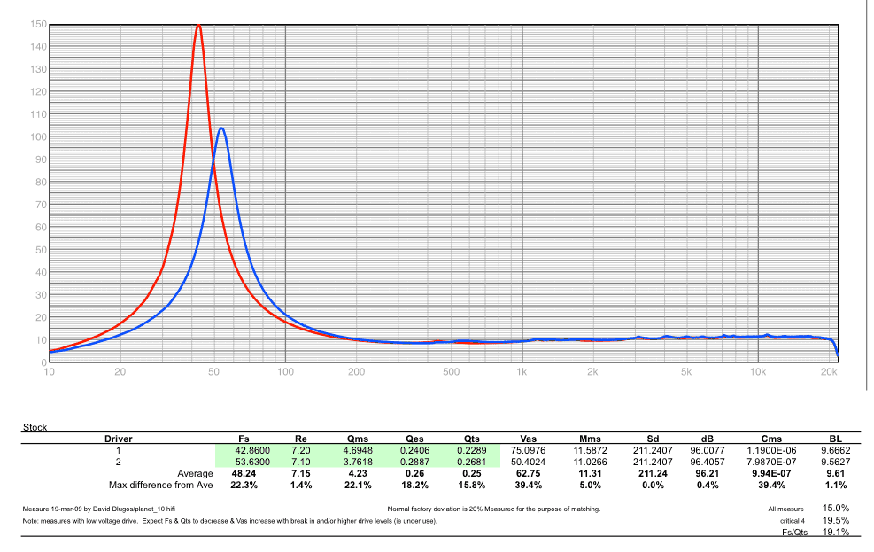

I would stay away from the stamped basket ANs, i have only seen those and was left unimpressed. The cast basket ones come with high praise, particularily the 8". I do not subscribe to the D Dick's school of box design, i have fixed one already,
If you order a pair i would also suggest getting a guarantee of pair matching -- being in Europe i would insist on seeing the impedance curves before ordering -- attached is the measures from a "pair" of stamped basket AN8 i am currently working over.

That didn't look all too appealing...

To me that does not look bad at all. Build one cabinet for both and do a blind test to see if you can tell the difference. Besides, if you are going to do an open baffle, the bass response hardly matters. Too much is made of the Audio Nirvana parameters. While they are probably poorly manufactured, they're still leagues ahead of the other drivers.
I'm also surprised in that there isn't a rising impedance, very, very typical of AN drivers.
I would probably not hear such a difference between the drivers, and I beleive in a cabinet such as the 2.8 Ambience, it would be even harder to distingiush.
