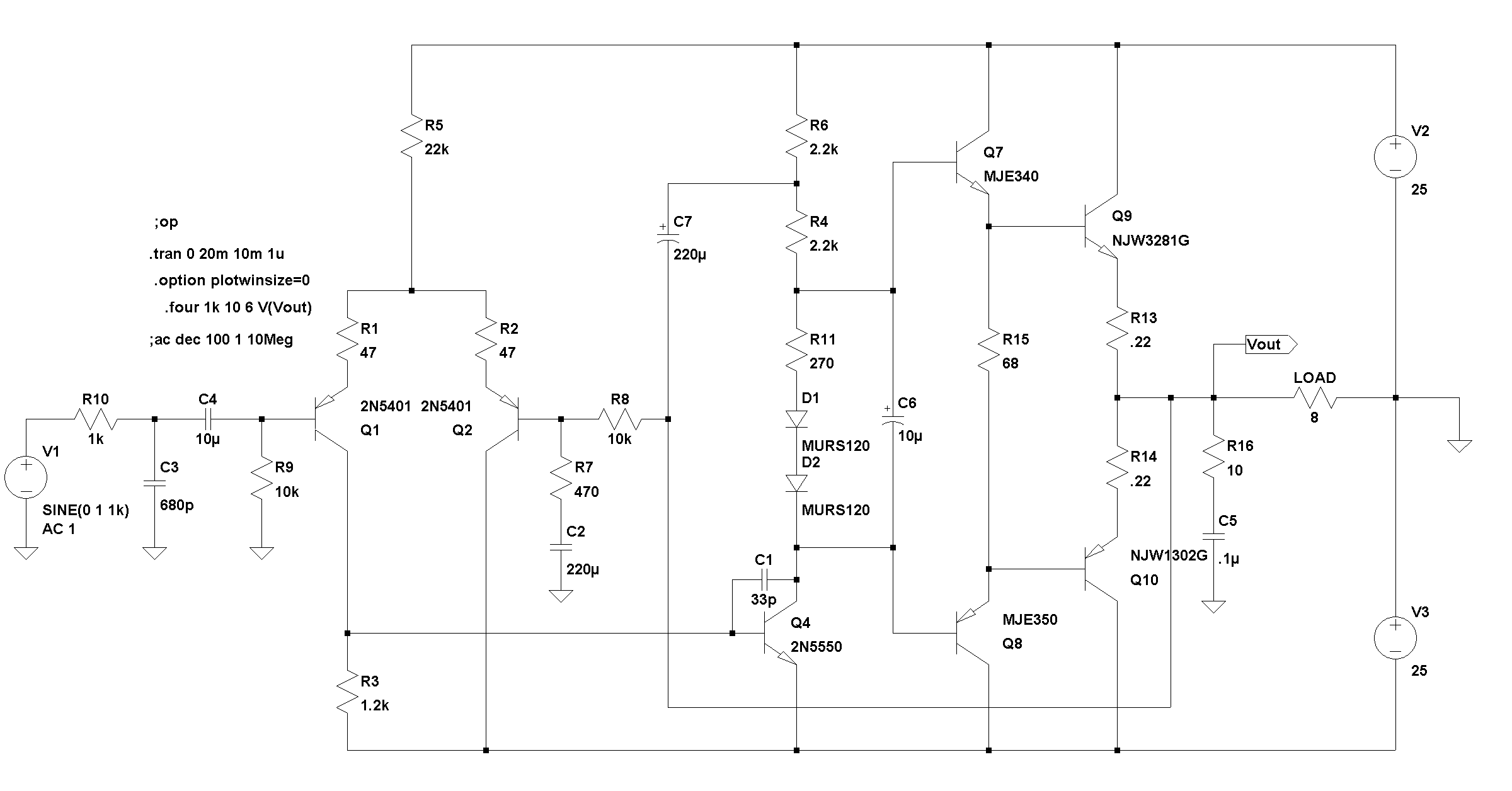

Is the opamp required in the design? Could you handle something fairly simple that is a discreet design? If the opamp is a required part of the design I'd suggest using it as the amps IPS and using a conventional discreet VAS and OPS.
For a simple discreet, look at something like this: It can give you power at the upper range you are looking for with signifigantly less distortion than you are allowed. The diodes would be mounted to the heatsink to stabalize bias. You could sub those with a Vbe multiplier, but the goal is as dead simple as possible with reasonable utility and performance.

In regards to the schematic jkuetemann posted, what is the advantage of using a diferential amplifier for the gain and feedback stage as oposed to an opamp? I've seen a lot of designs that used that but always thought that opamps provided a more linear gain and they have a differential amplifier as the output stage anyways.

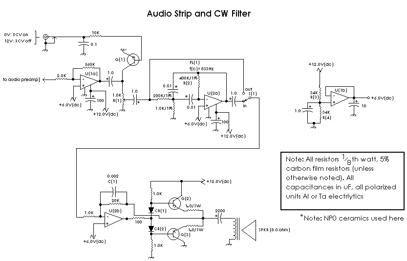

Your "perfesser" is an idiot. This is absolutely hideous! Here's a design I did for the audio strip for a longwave receiver. You can see here how to do a power amp design right. This particular final is just what you want: it's push-pull, and it's Class AB. Unlike that monstrosity your "perfesser" suggested, it sounds quite good, despite the fact that I wasn't designing for Hi-Fi, as this is a communications receiver, where fidelity is not necessary, and where it's not possible with a DBM anyway. 99.9% of longwave work is done in CW anyway, so it doesn't matter.

That design is a very simplistic opamp in itself, with the ability to drive the output directly. I does suffer from higher input bias requirements (lower input impedance) than an actual opamp. Some form of differential input is quite common as it provides really convenient nodes for input and feedback and helps reduce dependance on individual device characteristics. There is nothing special about the transistors I've shown, a few general purpose small signal devices and a pair of mid-power drivers and your choice of outputs. You could use your TIP31/32 for drivers and 2N3055/2955 for outputs if you like, they are cheap and readily available. Some resistor values have to be adjusted for significantly different supply voltages if the same quiescent currents are to be maintained, but the design is simple and solid.
