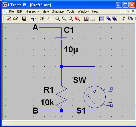

This looks like an okay circuit to me. You just have to know how to wire a mute switch that doesn't cause a DC offset.
Connnect the positive end of 10uF capacitor in series with the switch, and let's see, put a 10k resistor across the switch to charge the capacitor when the switch is off so there is no DC offset generated when it is turned on.
Connect the unconnected end of the capacitor to the bottom point of the mic element, and the "far" (unconnected to the capacitor) end of the switch to the other connection on the mic element. Or, this series cap-switch-resistor device might work as well or better between the bases of the transistors, where there is much less DC offset.
ETA: Your English is good, but if you can't read mine, here's a schematic:
Connect point A to the base of one transistor, and connect point B to the base of the other transistor
Hey!
I test this circuit and it works fine with no pop, but it isn't completely mute(but enough for my aplication). I put it between the bases of the transistors.
Just before I put the circuit board back in the plastic box I tried this circuit without capacitator. I didn't know what is going to start glowing or explode:), but I must tried:). And it worked very well, no pop and completely(or at least unhearing mute) mute. So, can you tell me, is there anything wrong with what I did? If it isn't, I would stick with resistor and switch(is the 10k resistor even necesary?).
Thank you very much for help!
p.s.:well, i think we understand each other good enough to solve the problem:)
