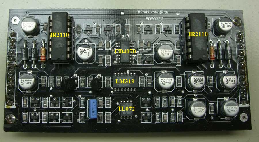

Hi Everyone!
i open this post for discuss the DLM4000 class D driver board circuit.
https://i00.i.aliimg.com/photo/v0/21...d_Circuits.jpg
First of all, i don't wanna know the name of occulted integrated circuit.
It's important to know that the 24pin chip, is a proprietary D-Logic circuit, that cannot be sold at DIYers or repairmen.
So, when this driver board has the 24pin-chip defective, you have to forget the repair (until you find a good driver board for another amp).
Anyone know what signals goes throu each pin?
for example:
pin1: +Vrail
pin2: analog signal
pin3: feedback
etc etc.
If it's possibile, post the waveforms for each pin:p it's welcome!
The objective is understand the circuit's behaviour, and build a DIY version with commercial parts such IR's gate driver with some comparators, smd passives, etc. (as the DWMs driver board, that have commercial IR's parts)
I know it's very very hard, but i think it will be a great help for several DIYers...and, maybe, someone has the instruments to build it own version of this driver board (maybe bigger, but ok).
This driver board is mounted in several class D car amps, like Powerbass 3000/4000, Ground Zero 8000, and much more;)

A class d amp usually has a triangular wave generator then the audio in and the triangular wave go into a comparator. The output of the comparator goes into 2 xor gates to phase split the signal for a hi/lo sided switch.

The DLM4000 board has 3 main chip:
- DLI4060B (24pin, d-logic secret function)
- common CMOS NOR-gate (as CD4001)
- gate driver IR211x (as IR2113s)
thanks to my "secret source"(:p), i discover that there's a similar driver board called DLM4500
An externally hosted image should be here but it no longer works. Please upload images instead of linking to them to prevent this.
this board has less parts, but the main is still DLI4060 (version A, with 20pin and not 24).
No other integrated circuits:rolleyes:
I think that DLI4060A (20pin) and DLI4060B (24pin), are similar.:rolleyes:
20pin version has:
- audio signal 1Vpp
- feedback
- strage triangle waveform (seems capacitor charge-discharge:rolleyes:)
- 2 square waves: one perfect 10Vpp, one 8Vpp with upper side "rounded"
- gnd
- +10Vdc supply
- -10Vdc supply
- perfect triangle waveform
- 1 little squarewave 2,5Vpp
- 2 dirty sinewaves: one distorted (seems "bent") 5Vpp, other 2,5Vpp + 2Vdc offset.
- shutdown (i see a lot ground signal, maybe one is shutdown)
All waves, sine, triangle or square, are at the same frequency.:) (100kHz for example)
DLM4500 outputs are classical hi-lo side squarewave as IR's parts:) One referred to -Vrail, one to +Vrail.
As you can see in the photo, beetween 20-pin chip and outpunt pins, there are only 2 transistor, some smd passives, and 2 4-pin integrated circuit (opto??).
In conclusion, DLI4060A is a comparator+integrator+clock (maybe the 2,5Vpp signal).
Possible?

I am actively trying to reverse engineer this sub board because it needs legacy support. Here is my contribution. There were two revisions of the 'sub' PCB on the DLM-4500 shown here. And of course my depotting work. A few of the pins are interconnected, most likely the power. The differences if you notice is the later revision has a chipset of which one has 2 more pins. Your pin count is off BTW. Count them again.
I would love to demystify this and create a legacy support board. Dlogixs wants 5 thousand dollars to do a single run. They are long out of production for this particular PCB and sub-pcb.

The revisions lined up, and Waveforms compliments of Perry Babin.
The DLM4000 You posted first is the latest revision 'B' 4060 of the Dlogix solution. Shown up top here is the earliest, and downward it evolves. So little was changed through out the revisions that you could swap any SUB-PCB between the 3 and it would work. The DLM4500 used the first Dlogix '1kw1ch' solution with the driver board built around it. It started as two parts under an epoxy glob, then went to two parts non-globbed with two additional pins, onto the DLI4060 'A' you see last which is now apparently being used on the latest driver board. Interesting how it evolved, but nothing tangible around it changed. At least not on this particular driver board.

If I knew that; We wouldn't be here.
I am going to try and draw a schematic AROUND the two piece boards. It will be a side project, and probably ugly. Hope your ready to help clean it up and look.
I see a 14 pin chip (CMOS logic? Or hi/lo driver?) and an 8 pin (guess...)
