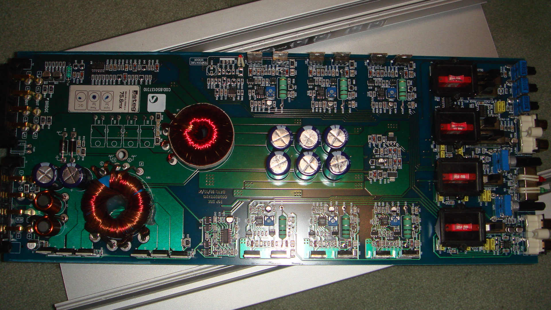

Hello,
my amp goes in protect-mode. Just connected power + & - & REM -> same state.
I measured the voltage up to the primary winding. After this nothing due to protect.
I dismantled the amp and checked every transistor and they are all ok.
The only bad thing i see that the legs of the transformer (2 on primary and 1 on secondary winding) are a little dark and smells very light burnt.
At this point im stuck. Any help is welcome also circuit diagrams...
Thank you!

The DC Voltage on all of the pins of the power supply driver IC.
IC# SG3525AP
Pin 1: 0 V
Pin 2: 0 V
Pin 3: 0,009 V
Pin 4: 0 V
Pin 5: 13,68 V
Pin 6: 0,008 V
Pin 7: 0,019 V
Pin 8: 0 V
Pin 9: 0 V
Pin 10: 0 V
Pin 11: 0 V
Pin 12: 0 V
Pin 13: 0,005 V
Pin 14: 0 V
Pin 15: 0,005 V
Pin 16: -0,196 V

it is the 16(narrow)-type, but i do not see the dot in the corner like in the picture in the datasheet... anyway when i flip the values pin 13 has 13,68V...

there are two paths:
1st path (from power supply to PIN 15):
PS (+) --> R1 to R4 in parallel --> Q26 + Q27 in parallel --> PIN 11
PS (+) --> R5 to R8 in parallel --> Q7 + Q16 in parallel --> PIN 14
Q16 + Q26 in parallel --> C30 --> C31 --> PIN 15
2nd path (from temp.sensor - "evaluation area"):
R251 (temp. sensor to enclosure, has 5,2 kOhm ?!?) --> PIN 15
U15 (Motorola LM3580, PIN 8) --> PIN 15
every R (resistance) tested --> OK, because same values in Ohm.
every Q (transistor) tested --> seem OK
I am afraid, that we come back to the windings... if the amp has temp. evaluation problems i should see the red & green lights and not just the red one (i assume that the green light is OK... )

here comes the third and last path:
3rd path (from U16, PIN 10 or 14 (bridged, PIN 1 and 5 also) to U2, PIN 15):
U16: 339, ST 93K021 (14 pins - plastic micropackage SO)
found the datasheet by searching "LM339 datasheet" ?!?
*Rxxx: these parts are just with one leg in path. Can i skip writing them down if the path is not broken?
U16, PIN 10 or 14 --> R219 --> *R217 --> *R216 --> Q43 --> *D17 --> *R215 --> *R214 --> *R212 --> U2, PIN 15
from the 6 channel amp sections in parallel to U16, PIN 10:
--> R211 --> *R212 --> Q42 --> *R213 --> R250 --> U16, PIN 10

Can you post a photo of the bottom of the board covering the area from the components around the 3526 to the terminal blocks. If the original photos are of higher resolution, please email me both photos.
babin_perry@yahoo.com
please take/download the high-res photo on the first page...
when zooming in i can read/see everything...
the 3525 is sitting in the area above the print of the pcb called "top side"...
PIN 15 is the second from top on the right side...
thank you again for your support!
bottom photo is on the way
