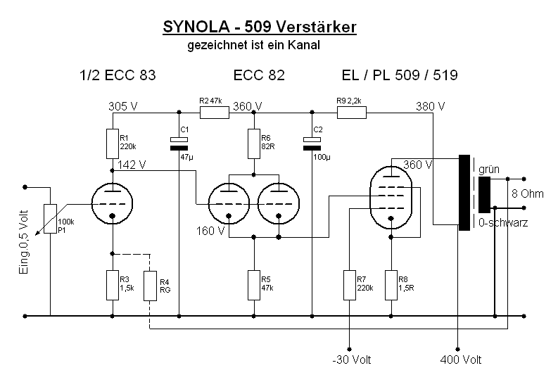

The Synola:
I must say it appeals more to me than the Danielak version (no hard feelings, Bob)
Driver stage weakness you say? Like?:confused:

The Synola [....] Driver stage weakness you say? Like?:confused:
Look at the xL509 screen driven plot; near the lower left corner you will find some pink color screen current "mini"-curves I also added. Then have a look at the paralleled ECC82/12AU7 sections CF driver feeding the xL509 screen grid in the Synola schematic and ask yourself if they would be able to source the needed current under any expected xL509 working conditions in this design - preferably in a most linear manner, of course.
Certainly there is room left for improvement in the CF driver stage of the Synola 509, but I can asure you it sounds very good already just using the schematic you pointed to. Hence my recommendation to use it as a starting point.

Thanks Tom, this kind of amp is new to me, so I was going to build it 'breadboard' to experiment and learn.
The OPT seems a delicate matter, I have some 4K7 I planned to use, but this seems rather high..
Driver stage weakness you say? Like?.....Certainly there is room left for improvement in the CF driver stage of the Synola 509
The driver is key in a screen drive design since it needs a bunch of transconductance and needs to be able to source screen current. In my experiments I find that the output tube plate voltage will be near zero when the screen grid is at maximum. The screen current peaks are far more than a 12AU7 can source without serious distortion. I have found that the best device for the task here is a mosfet since it fulfills the criteria and in follower application a mosfet doesn't screw up the sound. The SE circuit I used looked a lot like the Synola thing except the 12AU7 was replaced with a fet. The negative voltage on the output tubes control grid sets the idle current.
I find that most screen driven applications are more linear with a little negative voltage on G1. Too much negative voltage requires the peak G2 voltage to go too high leading to screen grid overload on peaks when the plate voltage is low. This is not an issue on music with infrequent peaks, but keep an eye on the screen grid when testing with continuous sine waves at full power.
