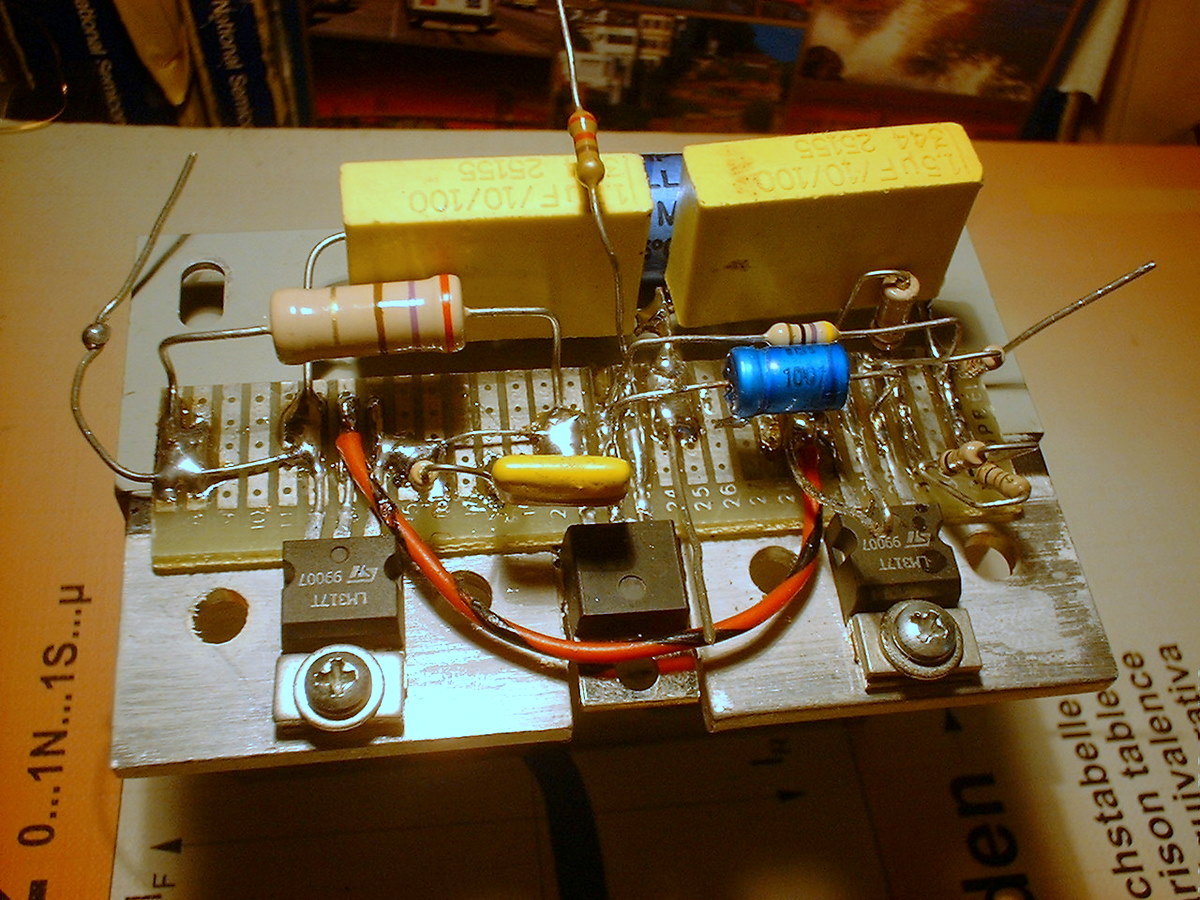

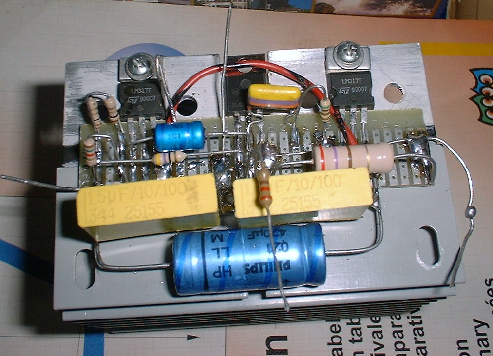

After the JLH, the Chtringlunator and the Voltage Regulator Chip Amp, here comes the Circlo, Half-Diamond Unity Gain Buffer, another "funny amplifier".
It operates in class A, and as usual, R2 can be halved with real LM317's.

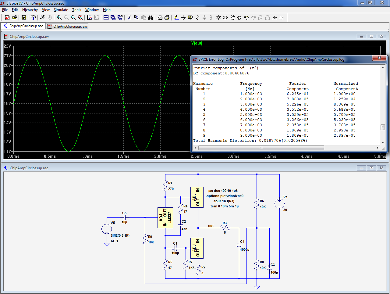

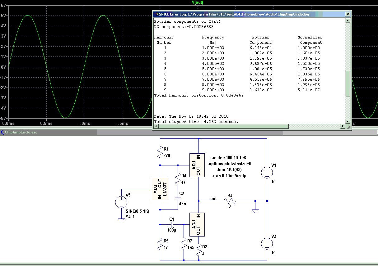

The simulated and measured distortions are in perfect agreement.
As a bonus, the complementary regulators half diamond topology has a negligible in/out offset voltage.

It is an attempt to balance the current swings of the two output devices:
The total value of R2 + R9 cannot go below approx. 1.6 ohm (1.25V/0.75A).
This imposes the effective transconductance of the lower device.
Balancing can then be made by correctly dimensioning R4 wrt. R3, but a relatively large R4 would be required, leading to a diminished negative voltage swing.
Splitting the resistance between R2 and R9 gives one more degree of freedom, and enables a symmetrical swing without the limitations.

-R2 should be halved for regular 317's: the models I used in the sim only have half the capacity
-This is a class A circuit, meaning a high quiescent current and dissipation.
