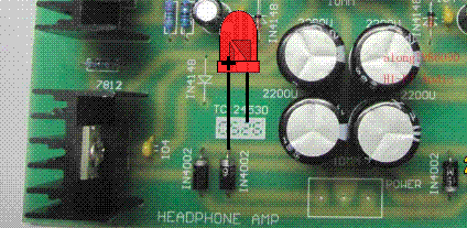

On the PCB there are diodes/bridge (1N4002) to convert AC to DC. So you can plug directly from the transformer 12-0-12.
You need cables and coaxial cable of course.
If was to add an led to indicate power on, what would be the best place to connect it?
I'm sure I could connect it between one of the 12v and 0v off the transformer but I'm not sure if that could cause some kind of imbalance. Probably a stupid question but you don't know what you don't know.

Transformer output is AC. A led has positive and negative ends, so you need a DC. You can get the DC (+ or -) after the rectifier diode bridge (4x 1N4002). In a diode bridge, 2 diodes join together (ends with strips) into positive supply and 2 other diodes join together to form negative supply. You can get the DC either from pos to gnd, or gnd to neg (or pos to neg for twice of voltage).
But you cannot connect the LED directly to the 17Vdc supply, or it will burn. Use a resistor at either ends of the LED to reduce the voltage. The value of the resistor depends on the type of the LED and the supply voltage.
With 12Vac transformer, after rectifier the voltage will be around 17Vdc (1.4x). You need resistor around(17V-2V)/0.02A=750ohm up to 1K5. 750 ohm usually too bright. I think 1K or 1K2 will do. With blue/white LED you need twice of resistance.
As for the casing, I have no idea. For such as small amp, why not DIY from wood or biscuit can hehehe.
LEDs often have a maximum current limit ~20mA.With 12Vac transformer, after rectifier the voltage will be around 17Vdc (1.4x). You need resistor around(17V-2V)/0.02A=750ohm up to 1K5. 750 ohm usually too bright. I think 1K or 1K2 will do. With blue/white LED you need twice of resistance.
That 0.02A is the maximum. I think you will find that 20mA and even 10mA will be far too bright for an indicator.
Aim for 2 to 5mA (0.002A). You can then add a second resistor in parallel to increase the current/brightness to suit your listening room without havingto remove/damage anything.
I strongly agree with Andrew. That is my experience too (tho I think that the specified maximum is usually 25mA or more). I just thinking that it may be only me who thinks that it is too bright, may be other will think that it is KEWL to have it too bright like that
So it is 7K5 to 5 times that. Parallel with 10K to make it brighter. But I think there is a certain brightness that will give a beautiful look (work in combination with the face plate color and material), so you can experiment with the resistor. I don't like red by the way.
