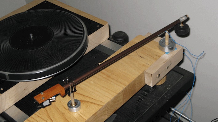

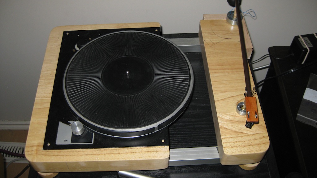

my latest iteration of "Nanook's 219 tonearm"..
This one is perhaps the best implementation to date. Still using Easton arrow shafts, still using inexpensive wire, a great bearing. Thanks to Bernie, I've added a Yamamoto inspired headshell.

yup...I'd like for folks who would not normally try their hand at a DIY tonearm. Technically not difficult. Biggest hassle is getting a bearing into the arm tube. I've managed to record the Sugden/"219" tonearm playing together nicely..(video). Unsure of the best way to post it on the Internet.
The arm pictured is effective length:= 330 mm

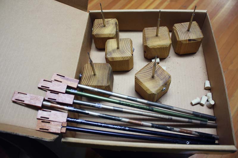

The parts sent to Dave were for 300mm (12") ones.
These arms perform at a level that is not embarrassed being compared to an SME 309 (magnesium).
Nanook tonearm

is installing the female portion of the bearing in the arm tube itself. For the ones I sent to Dave at the Van Isle DIY audio 'fest, I installed the female portions into the arm tubes. The bearing pivot itself or the "high quality tungsten carbide ball bearing in a precision carrier" is a cheap pen refill with a metal tube. They should be opened up and the ink washed out with solvent. Then refill with a light machine oil if you like.
You can use anything for a carrier for the "bearing" housing. I've used collars with a set screw. ? You will need something for a counter-weight (I use salvaged ones from old FUGLY turntables, but collars could be used there as well), it should weigh between 75-95 grams (no more).
I am not sure if Bernie had enough Yamamoto-inspired headshells for all the parts. That is the 2nd hassle. Making or procuring the headshells. Bernie's headshells were quite good. If you use 2mm screws and nuts to hold the cartridge, there should be enough room to "twist" the cartridge in the head-shell.
One thing not fully explained is my choice for mounting the counter-weight. I used masking tape on the arm tube. Then I made a little knot, tying a small piece of steel wire , and then running the wire through a washer and the counter-weight. Then I knotted it as close as possible to the arm tube. Because the wire doesn't slip on the masking tape, merely rotating the counterweight "knot" on the arm adjusts azimuth. Stupid simple :)
Hope that helps.

The "kits" i have, have a wooden base matching the headshell. All one needs to do is rig up a counterweight.
I have most of the slideshow... it is just missing a couple pictures. It should thou, be made into a pdf, not everyone has PowerPoint or Keynote, and i am running into a lot of people with issues of PP (older) crashing in the lastest OS.
Don't know what the cork is for.

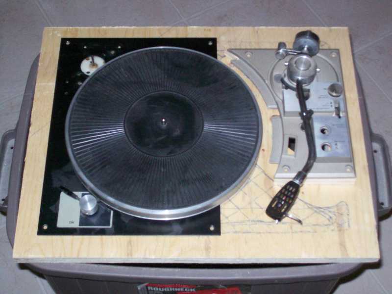

frugal-phile™
Joined 2001
BD-1 + Pioneer PL-514.
A budget giant killer. And you don't need to remove that arm to add a Nanook 129.
Mail me your address, i'll figure post... probably about $10-12.

Special secret ingredient. Grade8 steel insert, with polymer "filler" to limit the movement of the tip of the bearing...(set screw with a UV hardening epoxy).
the arm is better than it has any right to be and competes with my SME
