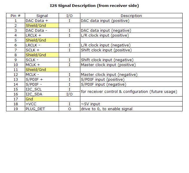

Some thoughts about optical isolation. There are more optical buses then just ethernet. One such an example could be MOST, that is used by AUDI MMI and other car manufacturers for their hi-fi audio-video systems. I have done some repairs to MOST based amplifers/MMI's and can tell that this interface is not another pc :) Basically only optical converter and programmable MOST interface chip. Obviously not a lot of most familiar programmers around here, but such options exists.
Btw, audiodesign posted XD1014EVB pinout, reposting it here. No more technical details is available for the moment as I understand.
