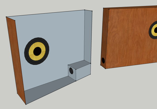

Unusual design for desktops - The Wedge
Here's a design I'm considering for use in a Uni bedroom. The concept is a Monacor SPH-30X in a ~2L ported enclosure. This doesn't give massive bass extension, but I have heard this confguration and it gives a suprisingly good rendering of most bass lines.
As these speakers will be on a desktop, it's nearly unavoidable they will be near a wall (in my case they will have to be right next to it) Hence, the enclosure is made very flat so as to gain baffle reflections from the whole wall, a bit like if the speaker were mounted in-wall (in theory). It should not require baffle step correction. The ports are mounted on the thin edges at the bottom, placing them very near to the wall, with the intention of gaining boundary reinforcement from the wall as well as the desk.
(image shows effect of baffle if compensated electrically. the driver is located to reduce frequency anomalies and make them complimentary to the driver's natural response where possible.)
The Monacor driver is very shallow as it uses a small neodynium motor. It is rather efficient and works in a small box volume, essential for such a flat design. It has a nasty looking peak at 10KHz, but this generally sounds ok slightly off axis. I'd probably build the front, back, top and bottom from 9mm plywood, but heavily braced. The edges would likely be made from timber planks, 12-18mm thick. The sloped enclosure both angles the driver toward the listener and reduces parallel internal walls.
I'd probably apply a roundover along the left and right edges, but it's hard to show on Sketchup.
I have concerns with this design (aside from the, imo, unappealing aesthetic!). The driver rear side is placed very near the back wall, how concerned should one be about reflections back through the light cone? What are good measures to avoid smearing the sound; acoustic foam behind the driver? The Edge gives a 'F2' frequency at 441Hz, is the enclosure thin enough to take advantage of the wall reinforcement with this in mind? I would assume so myself, the wavelength at this frequency is 780mm and the enclosure thickness is just 74mm at most, but this isn't something I'm experienced with. Would there be more leakage into a room behind these due to thier close proximity to the wall, or does it make no difference? They don't exactly pound out bass so I'm guessing not.
Any input appreciated!

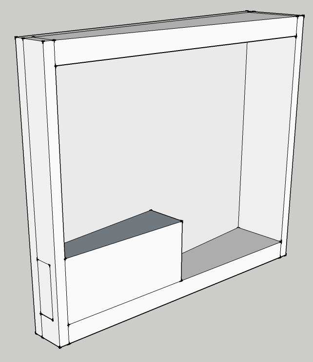

I had to re-think my port as it wouldn't physically fit on the side once the thickness of the front and back baffle were considered :eek:
I attach a model showing it with 3x13mm ports. I've moved them more towards the middle as I believe it's bad to have the internal port terminus too close to any internal surface, and in the original it'd be very near the bottom. As it is, they are still quite close to the rear panel, should I try to move them again? I could possibly drill them in at a slight angle to keep them away more.
I've tried to keep the bracing to the golden ratio, but only a few are in reality. Should it be sufficient? You're seeing 9mm plywood and 18mm solid timber in this model. With all the bracing, port and driver volumes taken away we arrive at about the 1.95L required volume. I'd plan to stuff along the bottom section, mabye the top too, and heavily at the port end of the enclosure (though not in front of the ports naturally!). I think I'll need heavy acoustic foam behind the driver and mabye on the rear side of the front baffle too. Thick felt may also be us some use, just to line things?
Overall, this will be difficult to build, due to the small sizes of many pieces and the sloping front. Any input appreciated! Perhaps it's a complete non-starter for reasons I may have overlooked? I don't know, it seems it should work technically, but it 'looks' wrong!

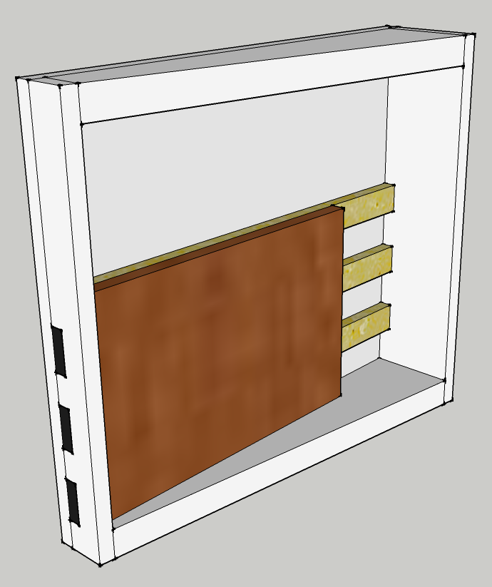

I was just going to say the same thing Chris. Also with slot loading the ports you'd get far more rigid cabinet walls. I say slot load them to the thin side and near the bottom of the wedge. As Chris has already pointed out the slot could be incorporated into part of the bracing and will also provide much less port noise than 3 smaller diameter round ports....
Hmm, I'm finding it hard to envisage exactly what you mean. I'm not sure how clear it is on my model but those 3 ports are drilled into a solid wooden block which will act as some degree of bracing. I couldn't reduce port noise without eating into more internal volume? I guess the slot is a little more volumetrically efficient though in an angular design.
I've drawn what I think you're suggesting, but am probably wrong! That is a larger port incidently, it was just clearer to show this way. I think this type of port would be quite difficult for me to build as it'd involve having a broad slanted profile bit of timber/board. I don't think it's exactly what you're suggesting though anyhow.
Thanks for your input!

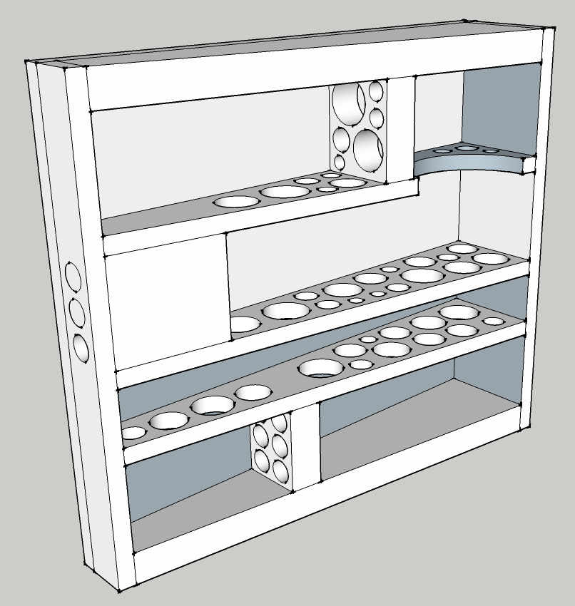

For an idea as to how to incorporate slot port(s) into the cabinet bracing scheme , take a look at any of the Fonken-esque enclosure designs at
Meet the Fonkens
FWIW, I'd imagine that the narrow end of your contemplated wedge design is not where you'd need the most bracing, so the port(s) could be accomplished with simple small panel(s), and full width braces might be overkill.
Ok, going by the Fonken bracing system I come up with something like the attached. Using thin timber beams and a panel of plywood to create 3 ports, they arn't any particular size this time.
I can see how this would in effect make the rear panel appear a lot thicker and more solid. I'm not sure how much it will do for the front, but I guess using a brace like I showed earlier will effectively tie the front to the extra solid back panel. Downsides however are that making ports long enough to have much bracing effect eats up a lot of internal volume. Also, they expand so far into the enclosure that they may be in the way of the rear side of the driver when mounted.
Is this what you were suggesting, or am I still thinking about it wrong? I can see how it works on the Fonken designs to add a lot of stiffness to the sides and hence the cabinet overall, but in mine I'm not sure it'd be so practical due to space limitations.
I think you've got the general idea - of course how much volume the port panels/bracing consume would depend on your tuning calculations. Note that in most variants of the Fonkens, the slot ports throat are quite narrow, (i.e. in the case of the "milli" and "micro" as little as 12mm ) and incorporate a 90dg corner, which allows the spacers and/or slot panels to become part of lateral and/or front to back bracing. Placement of damping material is also important - it's important not to occlude the internal opening of the narrow port slots.
Of course, on boxes as small as these, it doesn't take a lot of mass to provide strategic bracing.

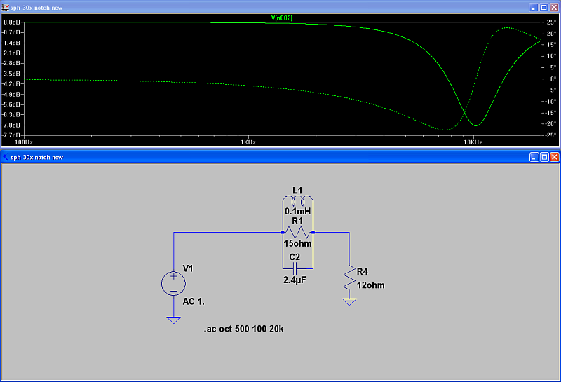

I've also been playing with notch filters. I know it seems a bit odd to use a passive notch when I'm building the amplifier myself, but I want to keep the electronics simple on this and the notch belongs to the speaker really. It is to tame the 10kHz peak. I'm currently testing one which gives about 15dB attenuation on the 4ohm version, made out of parts I have around. This seems like too much considering it will be used at least slightly off-axis and mounting near a wall is going to tilt the tonal balance away from the treble end as well. I think I'll use the one attached for a happy medium. I took the 12ohm speaker impedance from the plot on Monacor's site, which it shows as the value around 10kHz.

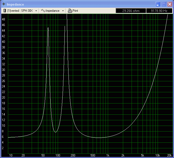

The impedance is a bit confusing. I have a simulation showing the predicted impedance plot of the driver in the box attached to this post. The impedance rise on this simulation is a lot more dramatic than the presumably measured one shown on the documentation for these drivers:
http://www.monacor.de/typo3/index.php?id=84&L=1&artid=4916&spr=EN&typ=full
The driver being in this enclosure shouldn't influence the top end impedance much should it? Which do I take to be true? I need to guage whether I will require a Zobel or not :)
