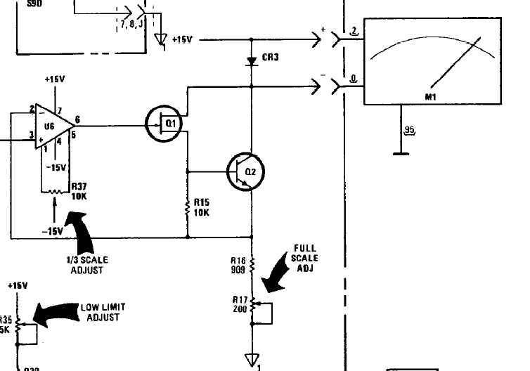

I got one HP339A and wonder whether is it normal for the instrument to behave like this on powering up.
When I turn it on, no matter what the input scale is, the meter swing to the very far end, then I turn it off immediately because I don't want to damage it. I wonder I should let its power on and let it have a chance to settle down.

My recollection is that it does - I used one for the entire decade of the 1990s, but not since, so YMMV..
This is normal for 339A.
Looking at the meter amp I see why.
Until the Q1 Jfet is biased off the meter is at full deflection.
David.

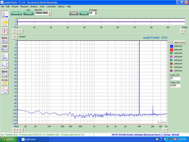

See my attachment for what is possible with a sound card. This is a capture of an acquisition loopback at 500mV and 10kHz.. Sample rate is 96kHz, and I can measure to a little over 40kHz, I can go faster if I need to do broader bandwidth measurements, but at some penalty in sfdr..

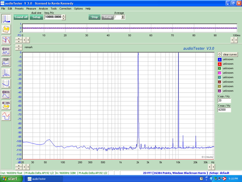

This set up can also do multi-tone and any pair of frequencies within the allowable range based on sample rate. Below 10kHz and 2kHz at 1:1 just as an example. You can see sum and difference tones at 8kHz and 12kHz which will give you a sense of the IMD performance of the measurement setup.. Considering what it all cost it's quite decent. I'm still working on it.. :D
