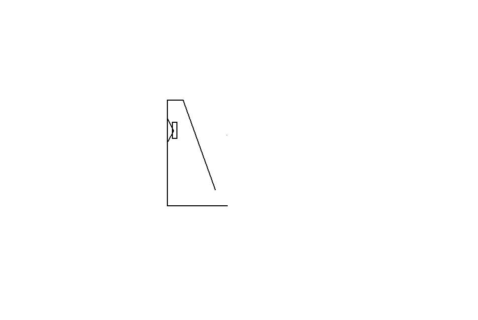

But fore corner load, or using backwall, maybe turn it the other way round

@ tinitus: excuse me if im clutching at straws here, but isnt what you propose in your drawing a voigt pipe?

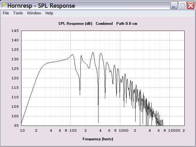

if only i could find an idiots guide to using hornresp.......as ive had a play with it and the SPL response doesnt look too clever.... big 10dB peaks etc....
area 1 = 290 area 2= 20-30 and area 3 = about 1000-1500 L1 = about 100 thus L2(if applicable...im a bit lost here) = about 100 also.
looks a rather rough though.....

righty ho!
well after a bit of tinkering, i have come up with this:
to my eyes it doesnt look great but considering its using a driver i have planned for TL at the mo, and that its only 87dB/W, the flatness and SPL gain was rather compromised. mind you i am primarily looking at this design from the stand point of a small as possible sub app, and i havent tried other drivers which may be much much better.whats the opinion of others?
Assuming this is a 2pi space sim, then it probably has enough BSC to be damped without losing too much and the high Q peaks will be ~gone, so looks good enough to try. If 1pi or 0.5pi it will probably require a lot of stuffing to keep from sounding 'boomy'.
