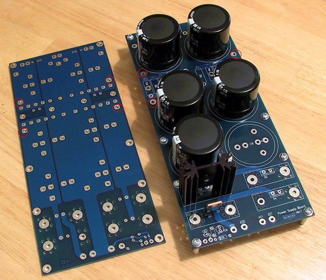

jtktam 19th February 2010 11:44 PM
i guess i should rephrase my question
i don't have a schematic so I am not sure which location to actually hook it up to on the board itself.. i know it's not "wireless"
-joe

bear 21st February 2010 03:36 PM
Quote:
Originally Posted by jtktam (https://www.diyaudio.com/forums/pass-labs/161600-foil-inducers-post2091493.html#post2091493)
-joe
Between the two "C"s??
Where the R would have gone?
Without knowing which board you have, it's hard to be specific.
Perhaps you can post a jpeg of the board??
The provider of the board doubtless has posted a schematic you can download.
BTW, foil inductors are likely a waste of good money for this application. Save them for speakers, imho.
_-_-bear

jtktam 21st February 2010 09:47 PM
i got briangt's power boards
An externally hosted image should be here but it no longer works. Please upload images instead of linking to them to prevent this.
i haven't gotten the inductors yet.. i will get some real solid ones, but not sure how to hook it up
-joe
Gyuri 22nd February 2010 06:52 PM
1 Attachment(s)
My dear Nelson!
Please do not be mad at me because of the remarks.
I know that if there is someone without malice, is you.
But some sarcasm to help cope with life.
Dear Joe!
You do not need to be angry also.
Returning to the inductors.
Red circles marked on the image to tie the inductors.
Best regards:
Gyuri
