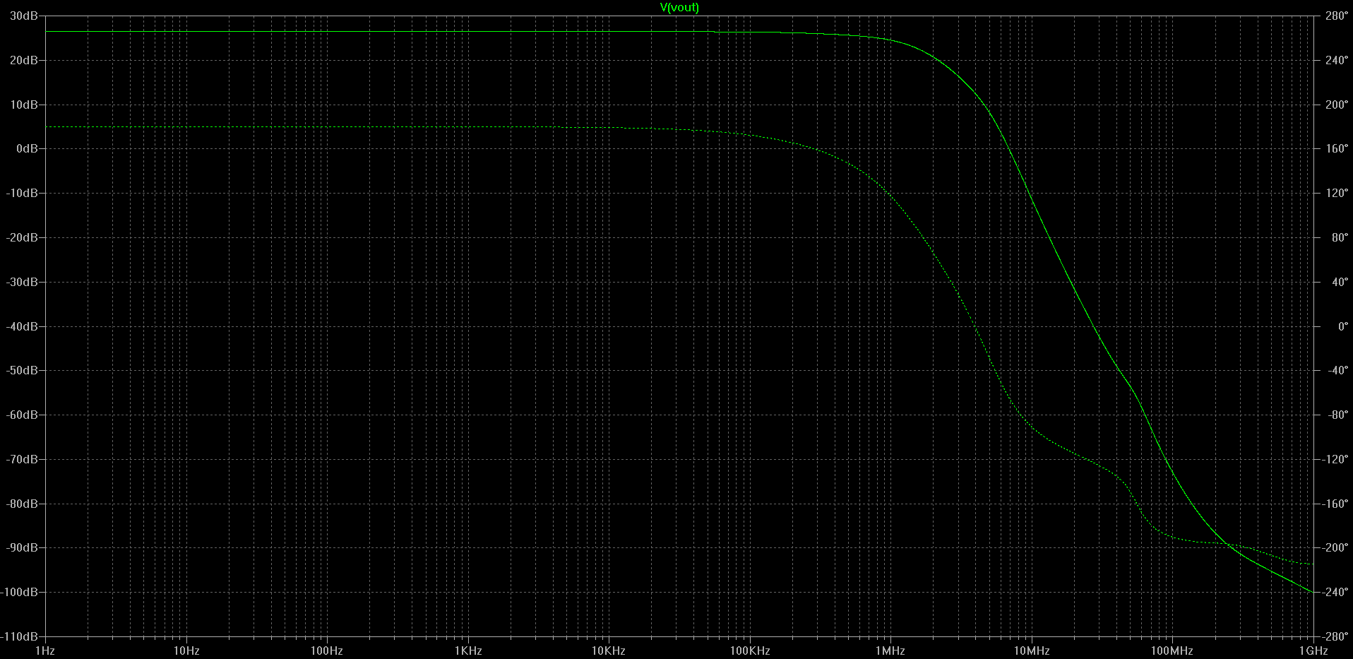

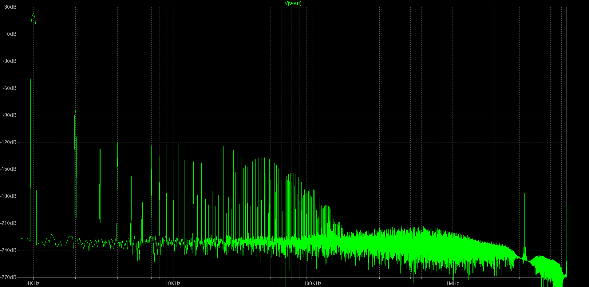

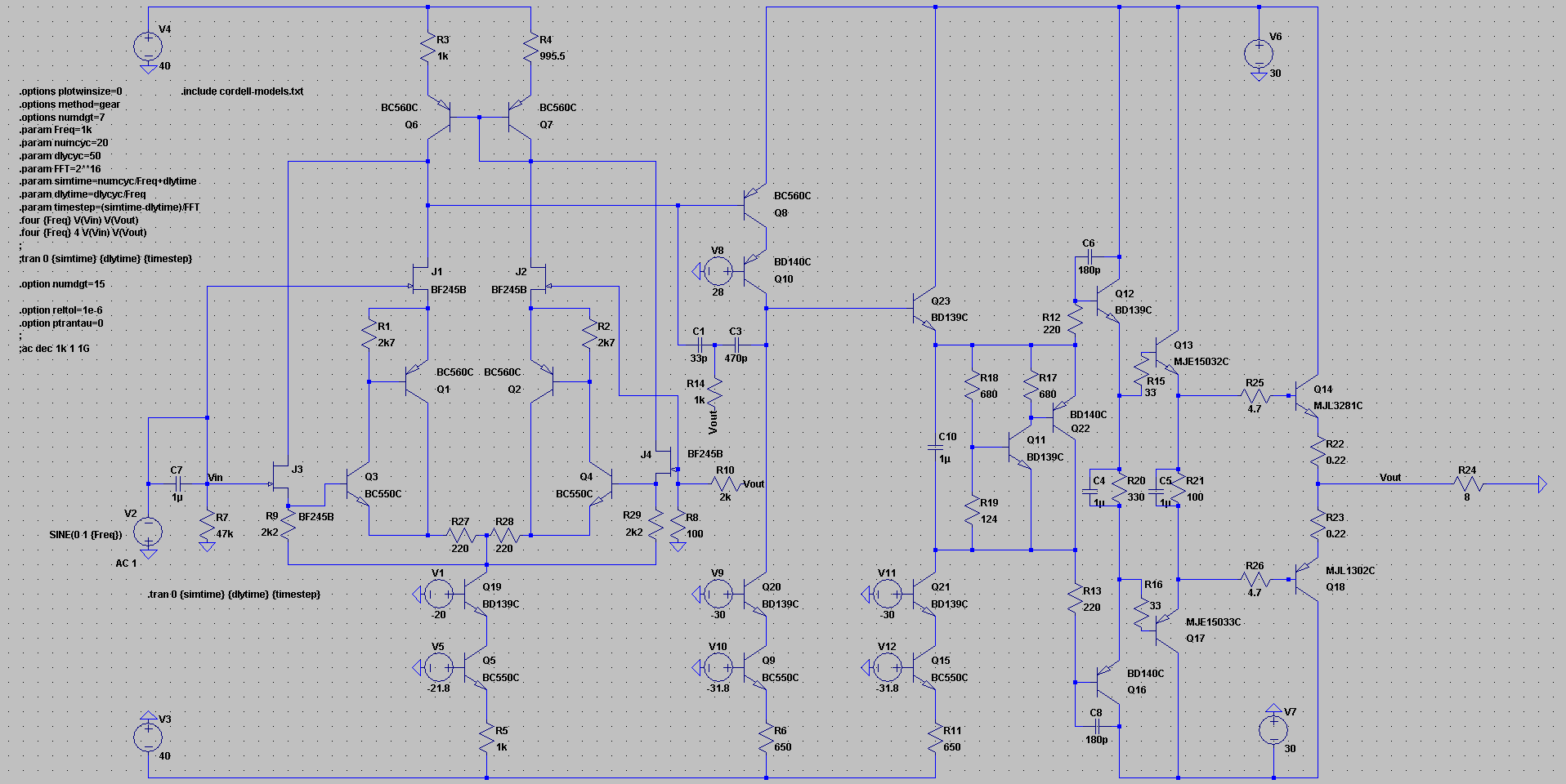

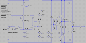

Aleph (Single Ended) + Larvadin (no Memory Distortion) = Ultimate Aleph?
I have heard about "Memory Distortion" and have read this one
http://www.lavardin.com/lavardin-techE.html
http://peufeu.free.fr/audio/memory/ (overview)
http://peufeu.free.fr/audio/memory/m...-complete.html (complete circuit)
http://peufeu.free.fr/audio/memory/memory-6-test.html (advanced second stage - see Fig. 6.2)
and then I thought more accurately about the Pass Aleph versions
http://www.patentstorm.us/patents/5710522.html Pass Aleph active CS United States Patent 5710522
http://www.pat2pdf.org/ (put in 5710522 for download)
http://www.firstwatt.com/downloads/seclassa.pdf
and I note the follow advantages/disadvantages
1) Larvadin models:
- no memory distortion through cascoded stage and sziklai darlington by input diff gain stage and cascode current source
- no memory distortion through double cascoded stage by second voltage gain stage and cascode current source
- cascode buffer stage as predriver for drive the true complementary push pull output power class B follower
- unfortunately no single ended class A output buffer and no class A push pull buffer
- unfortunately current mirror to create single ended output for first stage (I don't like current mirror)
2) Aleph models:
- no Class AB distortion present through single ended Class A output power common source stage
- unfortunately no cascoded version in both stages
- output power stage (no output buffer stage, i.e. voltage and current gain) instead source follower output stage (advantage or disadvantage ? - I don't know really)
Now I think about various mixed circuit designs of both topologies.
The result must be actually the ideal power amplifier, free from all kinds of distortion. Are there already designs in this kind?
I appreciate about your comments and information.
Thank you very much

Having very similar thoughts - I want to try a single ended (half of an) F5 with cascoded first stage. Alas no time for a couple of months, but eager for any input from the experts.

No idea what memory distortion might be, but if you like cascoded amps, look at Nelson's Threshold amps.
Have fun, Hannes

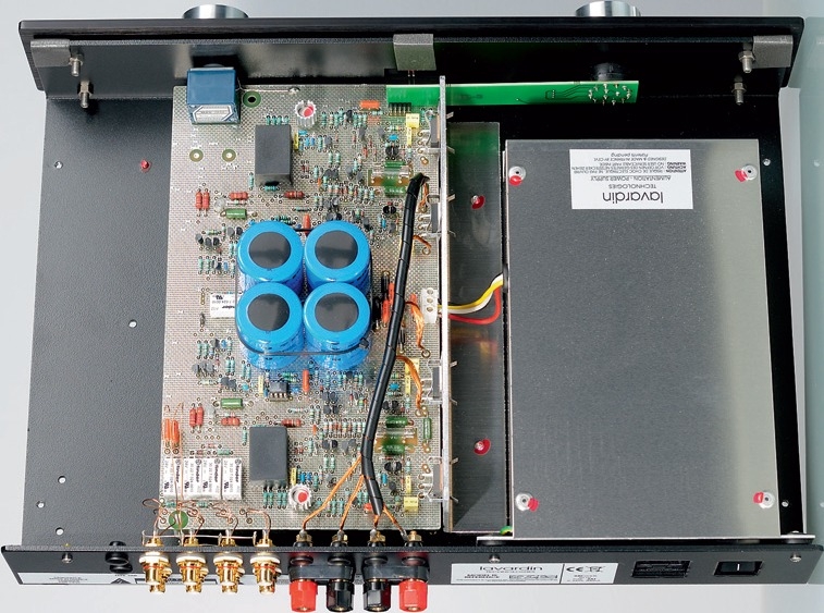

I owned the Lavardin IT amp a few years back. It was unusal in that it had a midrange that was very natural and real...valve like. It was also very musical and had a good bottom end. It did lack top end extension and air despite numerous equipment changes.
But yes i do remember it well as one of the best solid state amps that i had lived with.
"It did lack top end extension" ... typical effect of complex distortion (crossover distortion mainly create through only 20-50mA in the output stage. This distortion mostly audible above 2000 - 3000 Hz.

Nelson Pass 30th July 2009 04:34 PM
Quote:
Originally posted by tiefbassuebertr
This is one of the main reason why in most cases tube amplifiers sound better than such with transistors (solid state amplifiers)
This would be true if the tube amplifiers were operated that way, but
when you look at real power amplifier circuits, this causes such
inefficiency that power stages must be operated to the extremes
of voltage and current. They do not have the luxury of staying in
a small space on the load-line range.
:cool:
