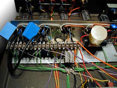

Here are some items you need for P2P:
Soldertags of various lenghts.
Solderlugs for earthing purposes.
Stand-offs for the soldertags.
Horizontal mounting clamps for PSU caps (if they're clamp mount devices).
Some easily plied metalsheet and a drill and punch for the sockets.
I've no idea wether RS is selling in Bresil but they carry all you may possibly need for this and more.
Cheers,;)

Having experience is of course a bonus but we all have to start somewhere... ...for it (P2P) sounds better when done right and it's a lot easier to repair/upgrade than PCBs.
Designing and making PCBs requires considerable confidence, whereas point to point makes modification easy. Both take time to learn.

Many capacitors are designed for PCB mounting, so they have radial leads only 5mm long. It's hard to use them for point to point...
Hope you're not thinking I am going to make a habit out of contradicting you, EC8010....
Actually those caps can be fitted easily, the trick is to use solid core hook- up wire.
