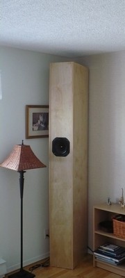

Super 8 sound
the Audio Nirvana super 8 sound very good with BIB design.

Indeed! I tried a couple and gave them to a neighbor to play in his 'boom car'. They sound pretty good in it.
Based on published specs, these drivers ideally belong on a small OB or sealed XO'd around 250 Hz to a proper wide BW HE mid-bass/bass system and either EQ'd flat or severely toe'd in. A BLH is a marginal option due to its high mass corner.
Driven with a high output impedance (preferably tube/tx. coupled) to flatten its response and lower its effective mass corner makes a BLH a better, though large, option or some type of MLTL if corner loaded or in a small, well constructed/damped room or a near-field app. Otherwise, the excessive ~24 dB BSC shelving will 'suck the life' out of it, so yes, a much higher system efficiency makes a huge difference WRT getting closer to the illusion of a 'live' event.
I agree that the BIB would be a good 'starter' system to listen to while you're pondering other options. Who knows, it may be enough except for possibly a super-tweeter to add a little top end 'air'.
