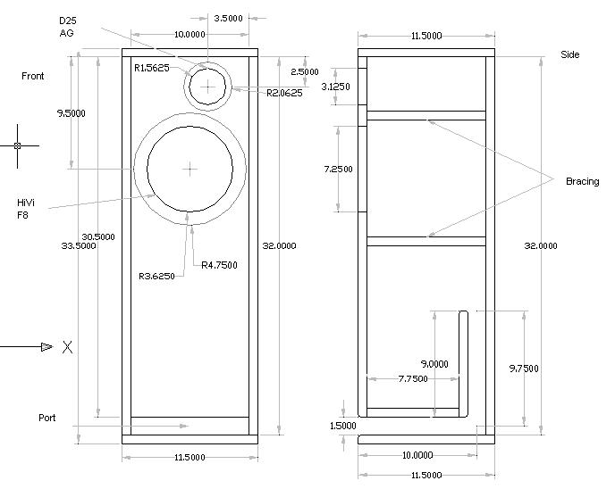

I've got some drivers in a box that I threw together last summer before I went to school. They contain HiVi F8's, and Vifa D25AG domes. The box is too small and ugly, so this summer I want to build another one. I need some advice on driver, port, and bracing placement.
--I haven't a clue where to put bracing, and I'm not sure If the port is in the best place (although it is convenient), or the drivers. How much should I offset the tweeter?

Here are my current plans:

If you want to try to optimize the response of the tweeter by offsetting it on the baffle, there is a program called BDS at http://www.pvconsultants.com/audio/frdgroup.htm which can help. I had difficulty using it myself, however.
I like rear ports , unless the speaker has to be placed against a wall. Any port resonances or out-of-phase midrange signals that escape thru the port will be less likely to be heard. As far as bracing, the object is to divide the long panels into smaller, unequally sized panels. So don't put a brace exactly in the middle, or divide a panel into equal thirds.
Turn it into a TL? How would I do that? I'd have to do a little more research on TL design, but I am considering one of those as a possibility. How would the size of a TL for this driver compare to a vented enclosure (.75 - 2 cu.ft internal)?

well i dont know what teh volumes would be i did not doany exact calculations besides the length of TL is usually related to your F3 and the area is realted to teh Sd of the woofer you can save a bit of volume by tapering the TL fro say 1.25XSd to 0.75XSd.
if you put a vertical partition between the port vertical and the front baffle and a horzontal partition below the woofer you can make a TL.

Also, will having the port at the bottom of the enclosure make it sound muddy?
-andy
A port can be anywhere, providing its not obstructed.
So, no. You won't have any muddiness from having a
port on the bottom. Maybe a slight breeze when walking
barefoot next the port while its playing, but no muddiness.
