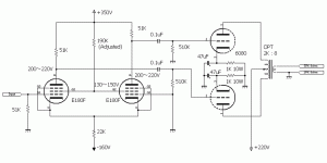

I have some 6080 valves which I would like to use in a simple-to-build yet good sounding P-P amp. I think this circuit from another thread fulfils these criteria:
http://www.excite-webtl.jp/world/english/web/?wb_url=ja1cty.servehttp.com/&wb_lp=JAEN&wb_dis=2
It uses a differential amplifier by a pair of Hi-gm of C3g. I have some hi-gm E180F pentodes which I think can replace the C3g. Is this so? As I'm not good at valve theory I would like to know what resistor changes this involves. Also, does such a circuit require a driver stage at the input in order to produce sufficient gain? I will be driving the amplifier from a separate 15-20dB linestage.
Thanks to all prospective helpers!

A Happy New Year to Joe & all,
I am so glad to discuss my circuitry of 6AS7pp. Here is a modified
schematic to use E180F/6688 instead of C3g. AS you can see,
the values of resistors are identical to C3g's. The key points
are as follows:
1: Adjust 190Kohm of G2 dropper to get 200-220V for both
plates of E180F/6688.
2: Confirm G2 voltage around 100-150V after above adjustment.
Because of Hi-gm of E180F, total amplifier gain from the signal
input jack to the speaker output will be more than 30dB which
is enough to get full power(9W) of the amplifier with less than
1Vrms signal input so that you don't need to use line amplifiers.

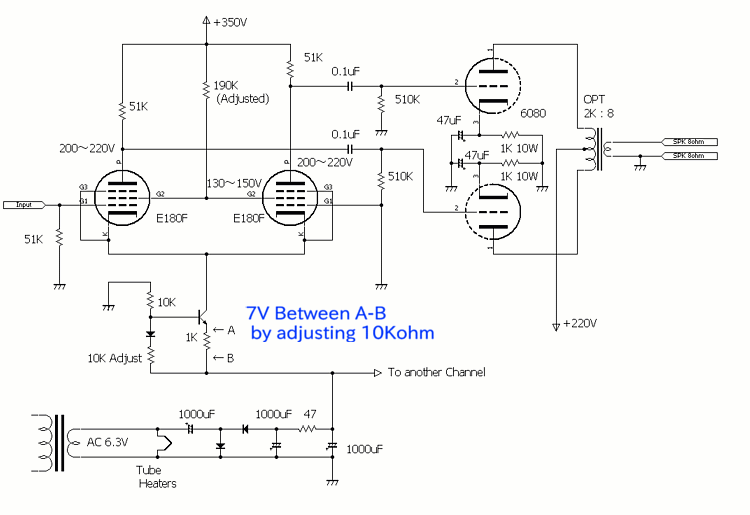

sonata149 said:
To: ja2dhc: In another thread you say that one can use a transistor CCS with about -15V instead of the -160V / 22Kohm bias for the LTP cathodes. As I'm not at all handy with transistors, can you please suggest a working circuit?
Joe A
Joe, here is what you want. It has not been tested by me, yet.
Rectifying Diodes should be more than 100V, 0.5A rated.
Transistor should be more than 50V, 100mA rated NPN transistor.
BTW, I will entry my 6AS7 amp to a contest for DIY amplifiers
in Japan in February.

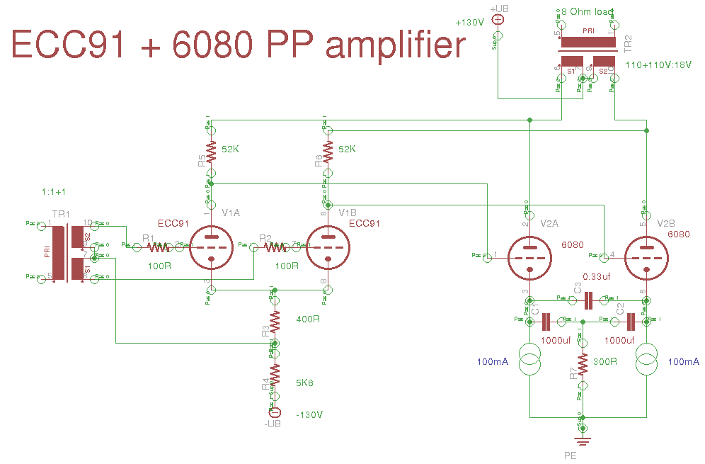

Heres what I came up with.
This design should need no adjustment as the CCS will keep everything nicely balanced.
The output stage has extremely good PSRR which means that a simple silicone diode power supply followed by a big cap should be adequate for the + rail. The negative rail should be a simple little Pi filter.
The ECC91 is a common cathode 7pin mini valve, so you have a lovely little direct coupled PP amp with just 4 valves in total.
The output transformer can be a power toroidal. I have built this exact same output stage and it works very well and is totally silent of hum. I used simple LM317 CCS originally, but the addition of direct coupling may make it neccisary to use something with a higher voltage rating. Something like a MJ350 in cascade should be simple and more than adequate.
I will be building this circuit in the summer.
Shoog

I was thinking about the design I posted and spotted one problem. You would need to incorperate a time delay on either the positive rail or both rails. This is because the 6080's will be hugely positively biased at switch on before the heaters come up. This will inevitably lead to flashovers and sudden tube death. A time delay on the positive rail is one solution, or a time delay on the center tap of the power supply mains transformer is another. This will allow problem free operation.
Shoog
