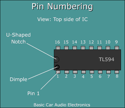

further looking at the amp i came across the njm2068l low noise dual operational amp the reading i got from one are
pin1:13.78v
pin 2:13.63v
pin3:13.79v
pin4:-0.047v
pin5:13.79v
pin6:35.12v
pin7:0.69v
pin8:nothing
wondering if this is bad all the other njm2068l's are showing a reading of 13.80v on pin 6 wondering if the one in queston is bad making the cap blow
You have the pin configuration wrong.
From what I can tell, the IC is working but has been shut down for some reason. You missed one pin.
