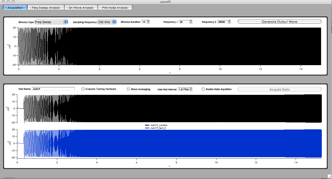

Here is a screenshot of the acquisition panel i have developed in igor. Analysis is running as well but it is not fully implemented at this time.
