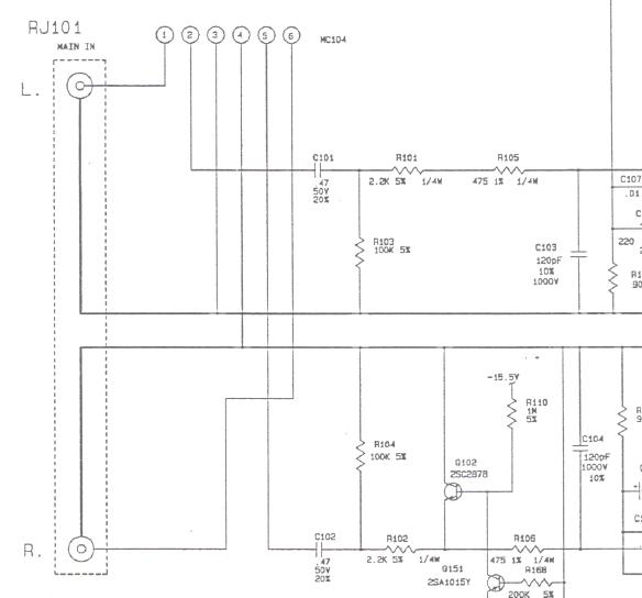

The problem does not seem to be directly related to the amplifier but it may be too sensitive to high RF levels in the input signal. A little RC filter at the input RCAs (1K ohm series and then 2.2nF to ground) could confirm this if it makes a substantial difference in noise level.
This is the RCA board.
Could you recommend how I would set up the above suggestion?
