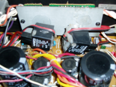

What type of Relay for a power amp? Electro-mechanical?
I have purchased a power amp (Carver TFM-55) and it has been modified to some extent.
It has a faint hiss coming through the tweeters when gain is set at max with no source signal.
Now there are 2 relays that have been added at some point in it's 15 year history.

I see they are electro-mechanical relays. I read that these can be slow but they are suitable for high loads. (I'm not too knowledgeable about these).
photo attached.
Could these be the source of the hissing? Also are these the right kind of relays for this kind of equipment? Do I need to change them?

Hi Brit,
when you disconnected the source did you insert a zero ohm (shorting) RCA plug into the amplifier input?
If not, then the hiss is probably due to the noise being generated by the high value of grounding resistor fitted to the input. This resistor sets Zin and is often in the range 20k to 100k. Rs should be less than 1k and preferably less than 100r. Shorting the input sets Rs=0r0 and shows best noise performance of the amplifier.
If the shorted input condition still hisses, it could be a high noise design or could be due to deterioration in components due to age and/or abuse.

build your own test RCA plug.
Short the input to ground with a very short copper link wire.
You can also make up non zero ohm input test plugs to mimic other source impedances. Buy some 1% metal film >=250mW resistors and solder them in.
100r, 1k0, 10k0 for starters.

my answer that involves solid state relays to audio .....it was just a teaser .....a joke to a rookie .....
there is no chance you use solid state relays in audio ....it always will be electromechanical ....and except these types of relays there is no other available
also i dont see that relays will produce and hiss, you have to look somewere else
