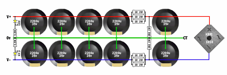

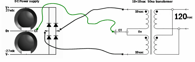

Power Supply
Here are CRC power supplies for these monoblocs:
https://www.diyaudio.com/forums/atta...1875_power.gif
Option: You can use 3300uF 35v or 50v caps, such as Nichicon FW or Panasonic FC.

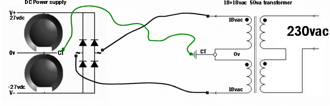

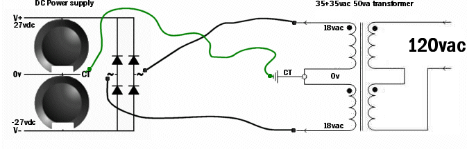

Transformer Voltage
Example transformer voltage is 18+18vac
Click on best match for your application to see a hookup diagram.
Your mains is 120vac and your transformer is 18+18 or less?
Your mains is 230vac and your transformer is 18+18 or less?
Your mains is 120vac and your transformer is 36+36 or less?(dual primaries in series)
Your mains is 230vac and your transformer is 9+9 or less?(dual primaries in parallel)
(please assure that the transformer output is 18+18vac or less)
And see Decibel Dungeon for a briefing on how to power your audio amplifier, including construction and safety.
Transformer Amperage
Greater durability can be had via good design and a right-sized transformer, or you could use a lot of fuses.
Monobloc/Dualmono:
♦ 36va*0.67=24 watts, which is perfect; however, we might want to adapt to dual secondaries and twin bridge rectifiers to maximize the little 1 ampere transformer. Use a mains fuse.
♦ 50va*0.67=33 watts, which is a bit too much; however, that's safe if given a Center Tap transformer (just one bridge rectifier) And the CRC power supply. Use a mains fuse and speaker jack fuse.
Stereo:
♦ 100va, instead of breaking chips, you may choose to use mains fuse and rails fuses for right channel amplifier board and rails fuses for left channel amplifier board and speaker jack fuses for each speaker. No matter if stereo or monobloc, a minimum of 7 fuses is mandatory if the transformer is greater than 50va.

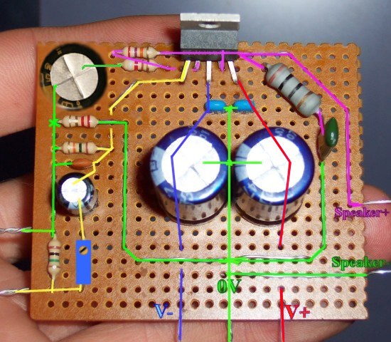

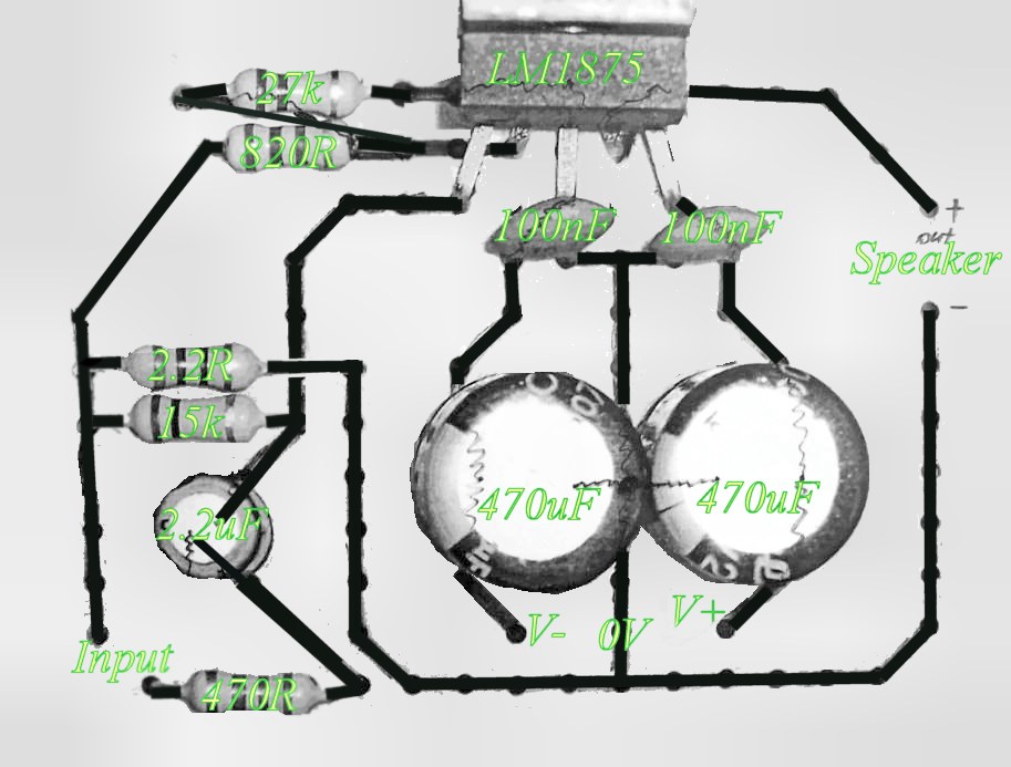

danielwritesbac 18th May 2008 06:07 AM
2 Attachment(s)
For example, here's an LM1875 that I built on veroboard (phenolic, no pads) quite a while back.
For now, I'd like you to see that the 5 pins are quite useful and well located.
Here we have the input on the left side, and the power circuit is down the middle, and the speaker output is on the right side.
The optional items were deleted from this photograph, so you can have a clear view:
Edit: Note that the ground stripe that's down the center doesn't connect to the LM1875 chip.

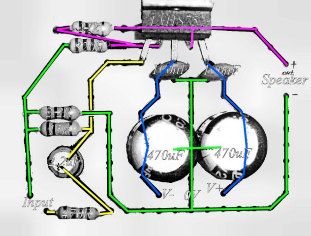

danielwritesbac 18th May 2008 06:11 AM
Parts list (per each channel):
LM1875
A size TO220 Heatsink Insulator
Phenolic board (veroboard)
Resistors
27k
15k
820R
470R
2.2R
Capacitors
2 of 470uF 50v electrolytic
2 of 100nF ("104") ceramic
This is about $6 worth of parts.
danielwritesbac 18th May 2008 06:56 AM
LM1875 in Technicolor?
2 Attachment(s)
Okay. I just got a request for "Technicolor"!
I can't wait to see John's reaction to this one. :D

Whoops! Where's the input filter cap?
I forgot to list the 2.2uF capacitor.
*This can be a "made for audio" electrolytic or a "poly" capacitor.
Application note:
Since LM1875 is a lower powered amplifier, you can use a poly input filter cap of a smaller value, so that it produces rich bass, but not lower than "about" 40hz. That "conserves" the power of your LM1875 so that it will play as loud as a larger amplifier. This poly cap can be as small as 0.47uF.
A friend sent me an e-mail about the missing cap, and he gave me some more goodies for our "optional components" section, which is coming up, right after the assembly demonstrations.
Thanks man!
Edits 18th May 2008 01:03 PM
