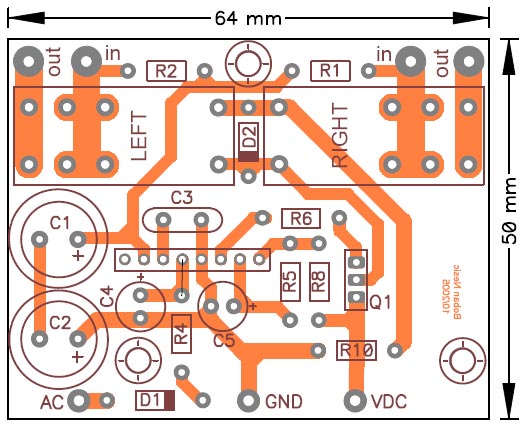

I'd consider Rod Elliot's board (it's very small), since integrated solutions seem to be disappearing.
According to the data sheet, the uPC1237 is also limited to 60V.
I like and have use Rod's board (his project #33). However I have a specific application and will be building up a board that have the relay(s) mounted on the board. I emailed Rod about licensing his circuit but he didn't respond. Although his board is good, component spacing is so tight that solder bridges are a real concern. This problem is magnified as he doesn't use a solder mask.
Well, I know you've used it because we've discussed it. Rod apparently had three design goals...simplicity, small size, and low cost. The latter is likely why there's no solder mask.

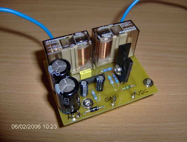

Hi!
Don't wast time here is complet!
Regards zeoN_Rider

zeonrider said:
3
Zeon,
Nice work. I'm working on a similar project and have found that the voltage at pin 2 will not exceed a few volts which would allow for a lower voltage cap. Also, why use 2 in series when bipoars are available? I always subscribe to the notion that unused input pins on a chip are tied to ground or V+ to avoid noise issues. On mine I have a zero ohm resistor going to ground on pin1. I also brought out pin 1 to a terminal, through another zero ohm resistor so that it could be used at a later date in case I want to add an over current sense.
