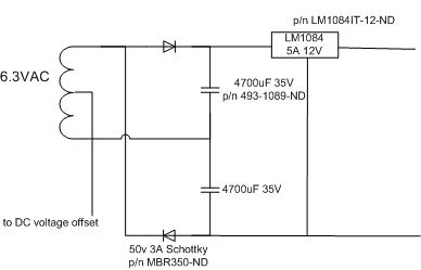

I am wanting to power 7 12ax7 tubes with DC (they are going on a PCB that has traces for the heater supply) with a transformer that only has 6.3VAC CT. I was thinking of using a simple PI filter so that the DC voltage will be kept high.
How do I calculate the values I use for the PI filter?
I tried using the duncan power supply designer, but I am unsure of the resistance of the load.
thanks

Can you set the PCB up so the 'X7 heaters run at 12 V.? Regulated 12 VDC supplies are easy enough to build and the reduced current demand HELPS.
The 6.3 VAC winding has to be rated at 4X the DC heater draw, which in this case is 1.05 A. "Full wave" voltage double the 6.3 VAC using a pair of Schottky diodes into a stacked pair of LARGE value 'lytics. Follow the doubler stack with a 3 A. adjustable linear regulator. Heat sink the IC well.
BTW, whenever you cap. I/P filter, count on being able to use only 1/2 the rectifier winding's VA capability. It's a matter of I2R heating in the trafo.
Thanks for the feedback gentlemen. Here is a schematic of the voltage doubler circuit with fixed regulation. I am trying to keep parts cost low and part count down as I have to produce a few of these amps.
What do you think?

About the floating vs connecting the CT to a DC offset. Why?
Biasing a heater supply off of B+ is done for 2 reasons. It prevents exceeding the max. allowable heater to cathode potential. The technique can be crucial in a DC coupled design, which employs both sections of a twin triode. The 2nd reason is noise control. Making the heater + with respect to the cathode keeps thermionic electrons emitted by the heater from flowing to the cathode. When heaters are AC energized, thermionic flow to the cathode can increase residual hum.
Neither of the above considerations applies (AFAIK) in your preamp, when the 'X7 heaters are energized with DC. Also, biasing a winding which is rectified might cause a malfunction.
