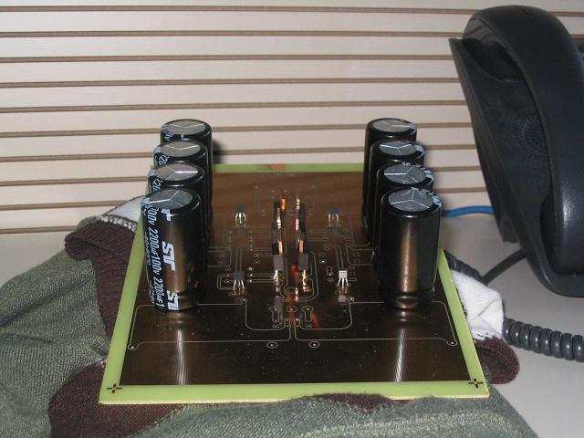

Speaking of aleph p thought, I still didn't want to post it till it wasn't completely finished and extensivetly tested.....but i can't resist to show you guys my board.....here it is.......
(I will attach a couple of pics of one channell of the Aleph P 1.7 .......obviously not all the components are on it... :) )

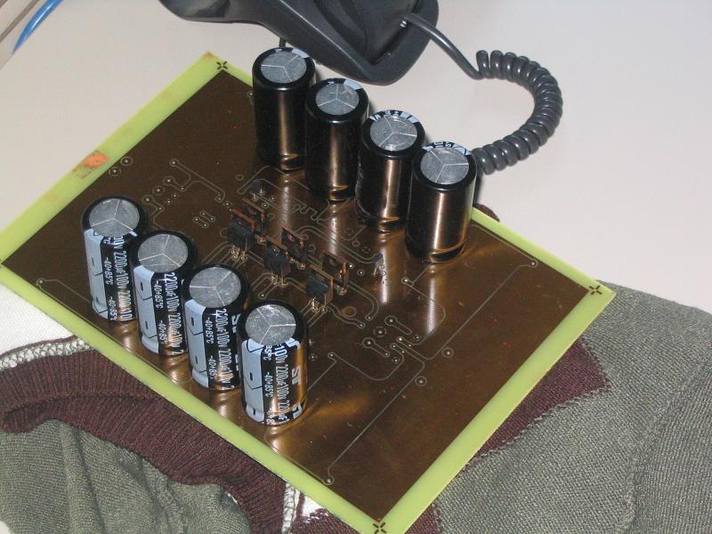

and here is another one....
this is a double side board.
Onn the bottom layer i have routed just the power supply and few signals (only higher and less delicate signals).
