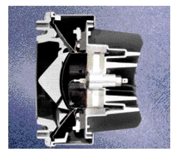

So here was my plan:
I wanted to take what was good about that egg shaped enclosure, and try to improve on it by putting a coax in there. But I also wanted to try something that David Smith alluded to here:
Detriments of a coaxial woofer?
"I did some measurements on the IM issue when KEF came out with UniQ. The issue is response variation with shifting woofer cone position. You measure the tweeter response and then DC shift the woofer in and out. With the KEF units the response was pretty consistent, so no IM.
At PSB I made some coax units with a waveguide on the tweeter mounted on a pivot in front of the woofer cone. Response was way better than any post mounted tweeter. Although the waveguide was fairly large it had almost no effect on woofer response.
The BBC did some interesting designs with tweeters mounted on a perforated plate in front of the woofer. JBL sells some pro ceiling speakers with the tweeter on a slotted waveguide.
Lots of fertile ground here.
David S"
So here's how this works:
We still have an egg shaped enclosure, but now there's a coax instead of a full range in there. And there's a phase plug on the woofer and a waveguide on the tweeter. The idea is that the waveguide will control the tweeters beamwidth, but the phase plug may 'clean up' the tweeters response.' The idea is to eliminate those early reflections off of the woofer cone.
Click the image to open in full size.
Here is a picture of the enclosure. It's basically an egg, with a coaxial, and a phase plug.
This cutaway illustrates how it works. The tweeter radiates via that waveguide. The woofer radiates via those rings. So it's similar to a Synergy Horn, but instead of a pyramid it's an egg.

Are you using a concentric and fitting a WG around the tweeter, a la Danley SM60?
