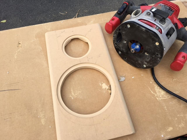

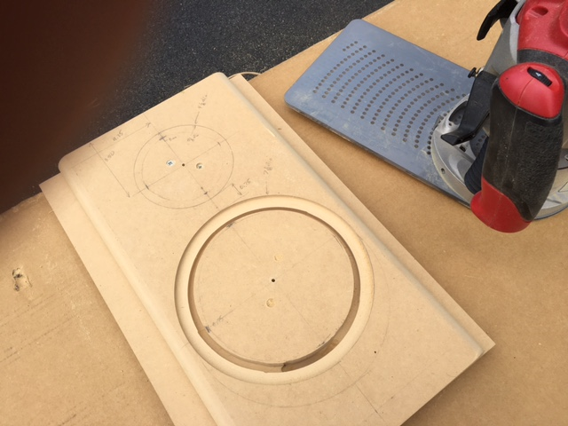

X's first experience with a real power tool
Most of you know me for foam core speaker builds and this is my first speaker with a real power tool (beyond a jig saw or hand drill). A friend loaned me a very powerful plunge router - he has 5 of them :) I used a circle cutting jig and a sacrificial backing board screwed in place. It all worked very well and the carbide blade cuts MDF like butter. An enormous amount of waste is generated and I am glad I did this outside. Anyhow, here are a few photos of what took me 2 hours to cut two, albeit, quite precise holes with flush mount rebates. This was a test baffle so I can make another but it turned out quite well.
Layout work:
Initial cut, so far so good...:
Finished:
Backside round-over for good mid range air flow:

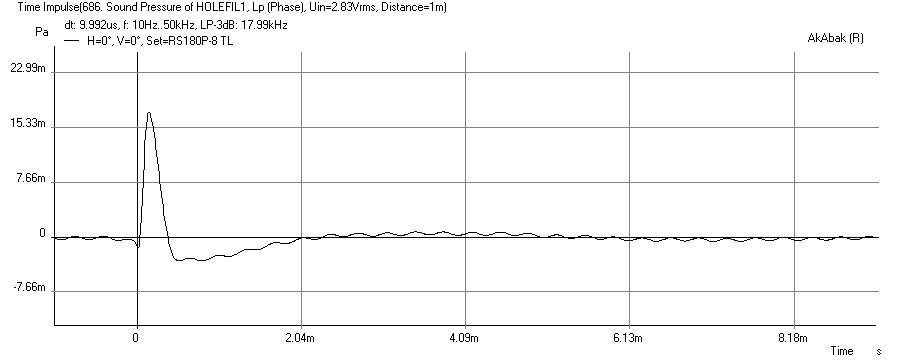

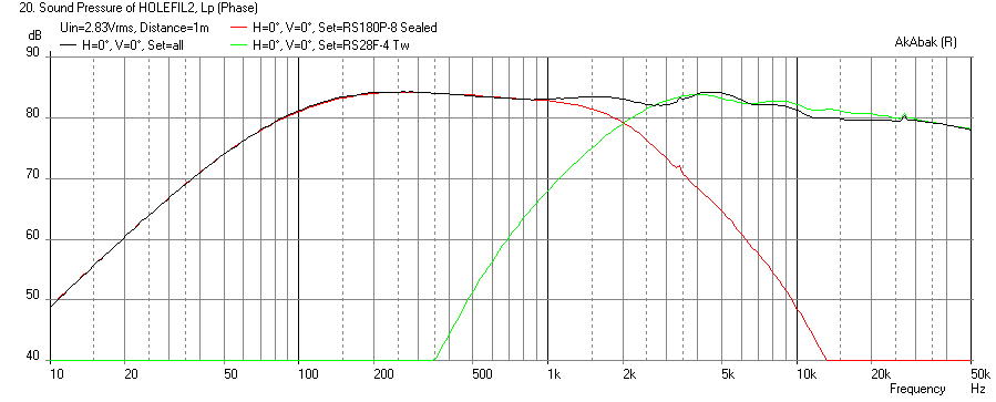

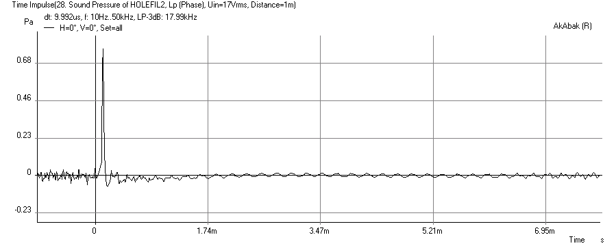

Sealed RS180P
Here is what this speaker might look like as a sealed alignment (assuming 14L chamber), not much bass with F3 of 91Hz:
571655d1474926301-rs28f-rs180p-b80-hole-filler-3-way-rs180p-rs28f-b80-hole-filler-sealed-fr.png
Although one can see how it really tightened up the impulse response into a narrow spike now:
571656d1474926301-rs28f-rs180p-b80-hole-filler-3-way-rs180p-rs28f-b80-hole-filler-sealed-ir.png
This will translate to a much tighter transient response. Hmm...

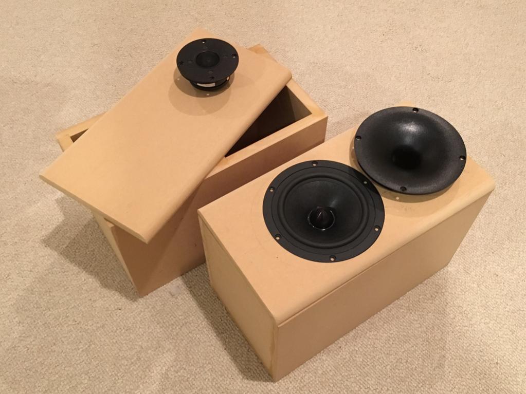

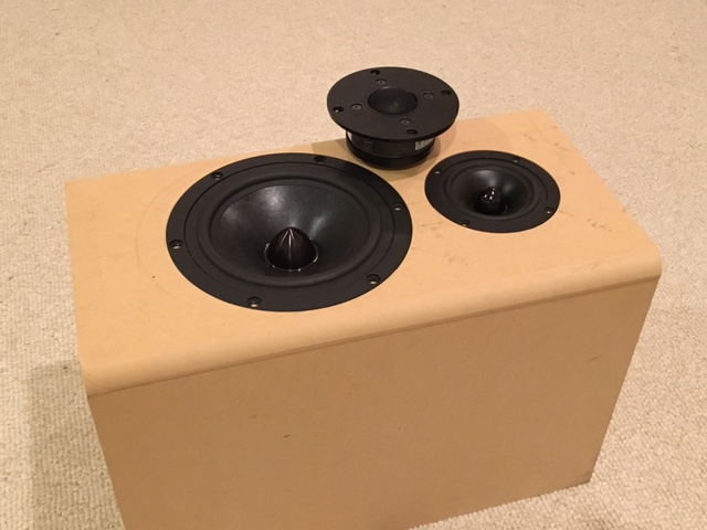

To give a sense of scale of the speaker - here are the bass and mid drivers fitted to the baffle on the box. The tweeter (or mid) will go on an external trapezoidal baffle mount that will be set back about 3.5in from main front baffle (TBD with measurement of time alignment). I think I need to look at simulated verticalnpilats in Akabak to see which way I should mount the drivers: TMW or MTW?

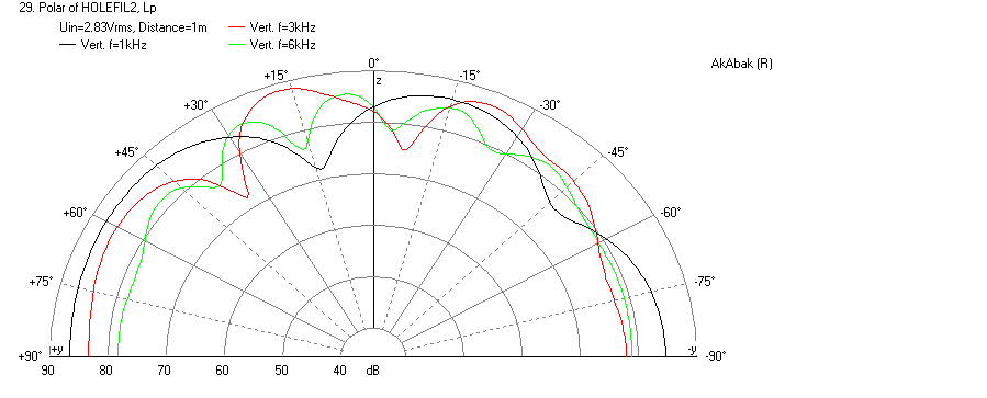

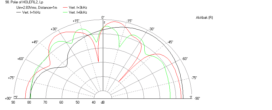

I'm exploring the differences in the vertical polars for TMW vs MTW and surprisingly, it seems that the MTW has a smoother vertical polar response. This may pose a problem because to get time alignment on the tweeter will require setback via a waveguide, which at this point was not part of the plan. Although I could cut a new baffle with provision for the WG, it would increase CTC spacing between between the WT and TM.
Vertical polar for MTW:
571755d1474980088-rs28f-rs180p-b80-hole-filler-3-way-rs180p-rs28f-b80-hole-filler-tmw-polar.png
Vertical polar for TMW - this one would indicate one should flip the speaker upside down with WTM and place it a little below ear height for best performance:
571756d1474980088-rs28f-rs180p-b80-hole-filler-3-way-rs180p-rs28f-b80-hole-filler-mtw-polar.png
These polars are a reminder of why I like my point source Trynergy/Synergies etc...

Still would like hear input from folks regarding the TMW vs MTW arrangement. So far it looks like MTW gives a smoother vertical polar according to my sims. Is this right because TMW speakers seem to be the norm in commercial offerings. Do I have this wrong?
If going MTW route I would need to redo baffle to accommodate a waveguide for the tweeer to allow sufficient setback for time alignment.
